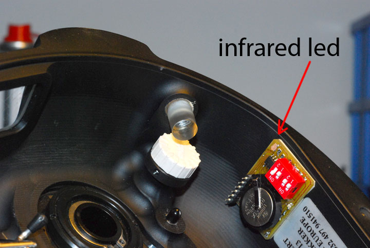

  8. does anyone have any experience with underwater timelapse with a dslr? I was thinking of doing some soon with the d7000 but the only problem is that it only takes up to 999 photos which wont be enough for what i want to do.
    I thought i could maybe just go and reset the timer over and over a couple of times, but just wanted to hear if anyone else had any better ideas, maybe taking apart an intervelometer and fitting it inside a housing somewhere?
    If you want more then 999 .... a prototype but it works fine!

  9. Nicely done! That's one tiny unit.
    The 4 DIP switches trigger the Infrared LED, 3 for the timings (5, 10, 20) and 1 on/off, that's right ?
    Are these pages the Canon's version of the Nikon's protocol you used ?
    http://www.doc-diy.net/photo/eos_ir_remote/
    http://www.doc-diy.net/photo/rc-1_hacked/
    Is there enough info to be started ? I know close to nothing in electronics but a friend of mine does and could give a hand.
    (A bit more just in case: http://www.arduino.cc/cgi-bin/yabb2/YaBB.pl?num=1198744543/3
    Also, the Gentles are very small units: http://www.gentles.ltd.uk/gentled/trigger.htm
    I send an email for enquiry.
    Finally, is the infrared led directly facing the infrared receptor in your setup or can it be on the other side ? The biggest space I can find in the Aquatica 5D housing is on the lower left, underneath the camera on the left of the plate.
    In any case, thanks for pointing in the right direction!
  10. The 4 DIP switches trigger the Infrared LED, 3 for the timings (5, 10, 20) and 1 on/off, that's right ?
    It is possible to make 23 timings with the dip switches ... so one for on/off :(
    The timing off the bursts must be exact!
    With my D80 the unit was placed at the back shell and the back off the IR receiver.
    You have to try this out. Good luck!
  11. It is possible to make 23 timings with the dip switches ... so one for on/off :lol:
    Cheers! However, I'm not sure to understand regarding the timing of the bursts. Do you mean the IR protocol ?
    Additionally, here's GentLED feedback:
    This is tricky. You can remove the black plastic housing, that reduces the size to 38x24x13mm, but that excludes the toggle switch that sticks out. See the jpg I attach, you can see the shape is not square so that may help?
    Note that the IR light comes out of the top side and this must point to the IR sensor on the camera. It needs to be within 5cm and doesnt need to be straight towards it. For a small charge we could make one without box and with IR LED on short wire so you can lead it nearer camera sensor? This is a little fragile but once installed in housing it may be good Does this help?
    James
    In the Aquatica housing, the largest space I can figure is underneath the camera on the left. But the toggle switch might stick out too much from the back of the camera against the housing's lip. Maybe a replacement with a push switch is enough.
    With the IRled pointing from the left front underneath the camera, the 5D sensor might catch the signal.. Otherwise, I asked for a quote with a short wired IRled and if the wired IRled can be easily replaced.
    Standard unit is currently 30 pounds so it's worth a try.
