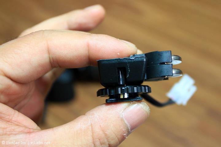

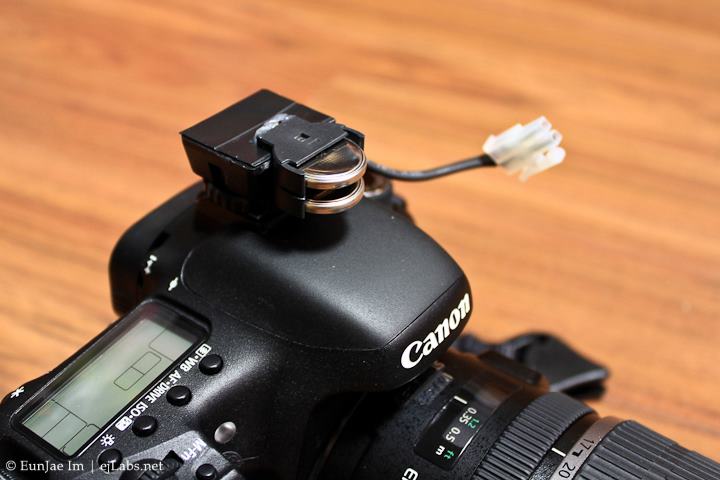

  16. Very nice rtrski.
    My led trigger for Nauticam housing ended up like this.
    Led module separated(two IR LED 850nm = almost no visible light but it's triggering very well Inon's strobes).

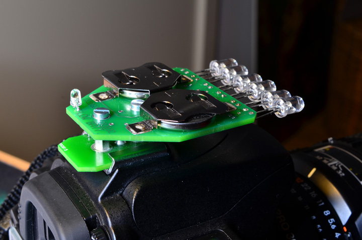

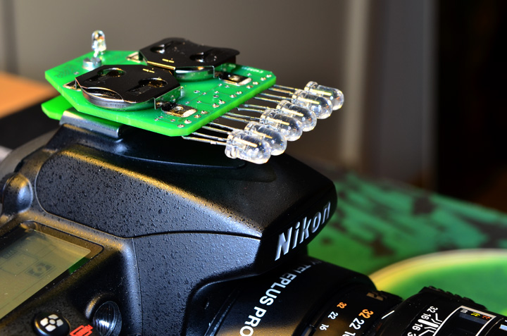

  19. "Star Trek Enterprise" :)
    My design, uP controlled, supply 2x CR2032, low battery warning, hot-shoe with spring contact,
    goes to sleep so no battery consumption when not used (battery's can stay)
    red LEDS, (2 cd), can be bent to the fibbers, those not needed can be cut off.
  20. "Star Trek Enterprise" :)
    VERY nice...you've clearly got access to some good circuit etching capability. And I like those low-profile battery holders as well. I hadn't found anything quite that small but I was searching for 2x stackers vs. using two single-cell holders side-by-side.
    I'm guessing your chip is on the bottom side, and that's a double-side etched circuit board. Or maybe it's on the hotshoe sub-board?
