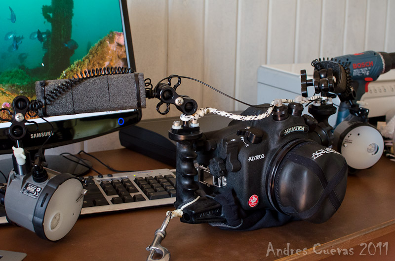

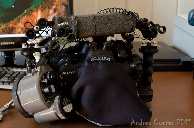

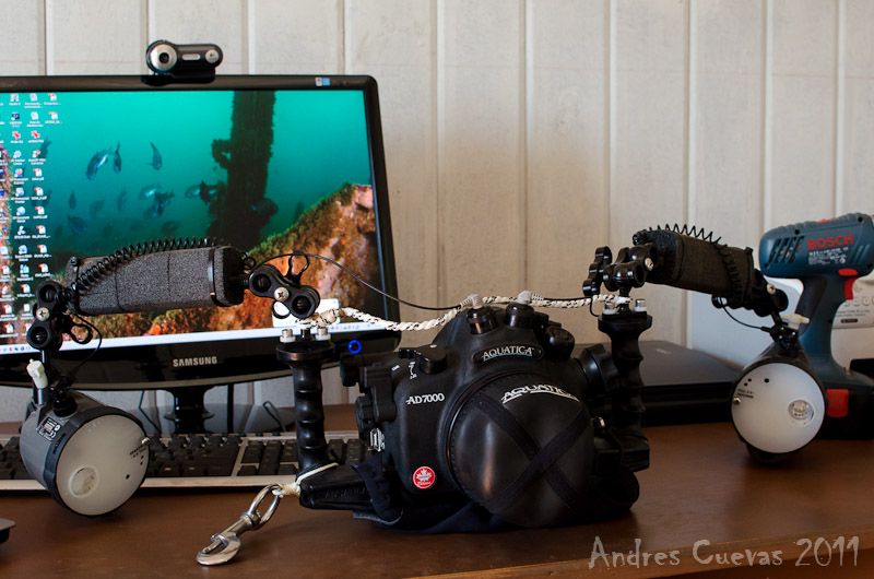

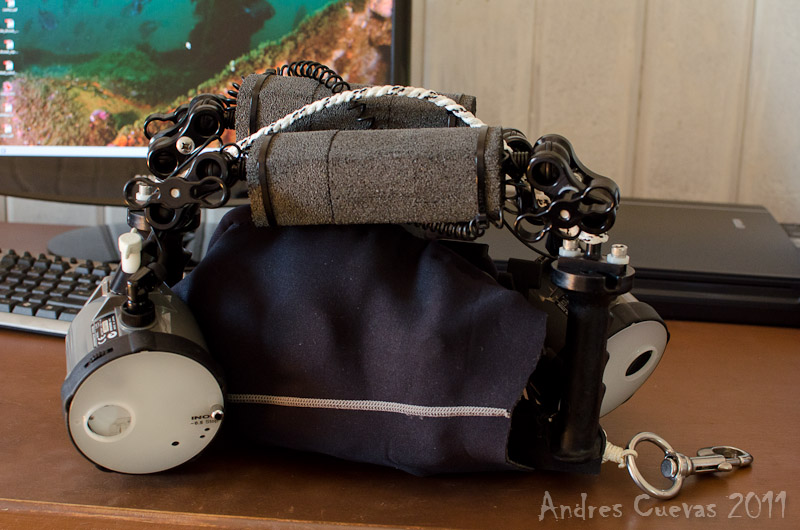

  1. Yesterday I went to the pool with my complete rig for the first time, you can see more details about it here
    First thing I noticed, was that my rig is too negative underwater.
    My configuration is:
    - Aquatica Housing AD7000.
    - Aquatica Mini Dome.
    - Aquatica Extension Ring 18456.
    - Aquatica Zoom Gear 48717.
    - Nikon D7000
    - Tokina 10-17
    - 2 x Inon z240
    - 2 x 8" ULCS arms
    - Stix floats
    I think I will need to get some jumbo Stixs, but I'm not sure how many floats I need.
    Does anybody in the forum has a similar rig that can give me an approximation about how many jumbo floats I need?
    When not in use, this is how I put the rig underwater and out of the water too:
