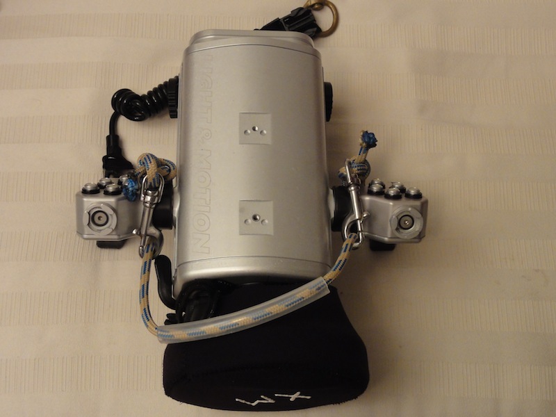

  4. These holes are relatively shallow and quite close from one another, so I would feel myself a bit worried that anything attached to them may be ripped off in sudden move as is often encountered when a swim step attendant grabs a camera from the hands of a diver... I find the inexpensive solution I pictured here to be quite convenient (although, even though I tell the guys not to pull the camera by the rope connecting my two light arms, this is what they invariably end up doing after a while :-).

    John, the "handle" you are talking about in my "design" is precisely NOT a handle. It's just a safety connection between the two ULCS arms, in case one breaks loose from the L&M handle (god forbid!). The real handle consists of a small rope (with a piece of flexible tubing around it) which is wrapped around the base of each handle (probably the most reliable locations to hold the housing from), and clipped to itself with two quick release clips at both ends. But as I said, I have a hard time explaining to the swim step guys that NO, you should not grab the ULCS arm "connector"!

  12. The rope is not attached to anything. Just wrapped around the base of the handle and clipped to itself at both ends using the quick release clips (to easily get rid of it for storage). I have trouble seeing how those plastic rings could break unless you would carry the housing from one handle (which my design is supposed to prevent, as this is something I could foresee being a problem on the swim step). If you are using one of the top threads for a third light, this will obviously not work for you unless you can find a way to flip the arm down before grabbing the rope... It's worked fine for me for more than a year now. Knocking wood!
