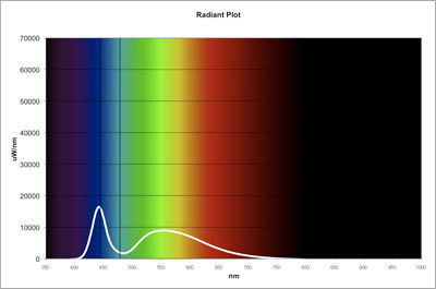

    I read the specs. For video, 6500k is quite a bit on the blue side of white. Underwater, I would rather be slightly on the red side of white if you're going to be off from 5500k. There are now LEDs that can do that w/o using filters. Thing is, they are so new I don't know of any companies actually using them in production designs at this point.
  8. I read the specs. For video, 6500k is quite a bit on the blue side of white. Underwater, I would rather be slightly on the red side of white if you're going to be off from 5500k. There are now LEDs that can do that w/o using filters. Thing is, they are so new I don't know of any companies actually using them in production designs at this point.

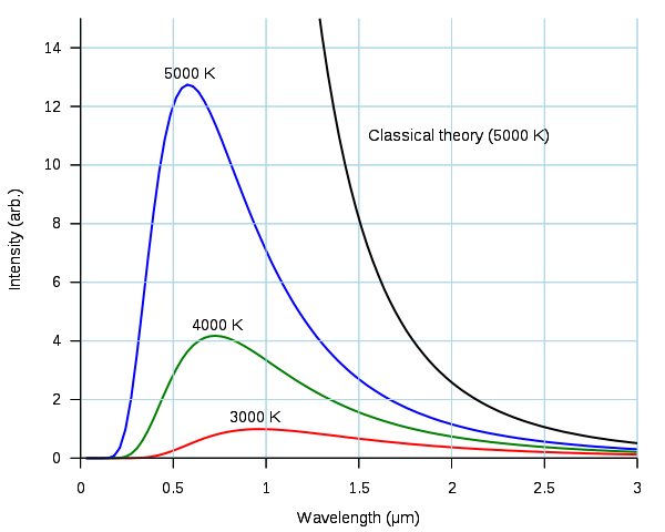

    Assuming that the spectrum shown on the Light & Motion website is that of the Sola, the attribution of a color temperature is a bit problematic, as it is comprised of two main "peaks":
    (from http://www.uwimaging.com/sola1200v.html >> Lumen Test >> About)
    A black body spectrum is single-peaked as shown here:
    (from http://en.wikipedia.org/wiki/Black_body#Pl...body_radiation)
    This pedantic comments being said, I happened to be at the opening of Blue Water Photo in Santa Monica yesterday, where I was shown the Sola 1200 (now I know why they were back-ordered for other dealers!). Since I was coming back from my first dive with the VL1300, I asked to make a comparison of the two lights (in the store).
    My qualitative impression is that the Sola emits a whiter light than the VL1300 and if anything, the VL1300 emitted a yellower light (so a "cooler" temperature in black body theory). Brightness is difficult to gauge, but I had the feeling that the Sola was brighter than the VL1300. But again that's difficult to assess objectively, especially when the light color is different.
    Scott Gietler, the store owner, thought the Sola was more uniform and since he is much more experienced than me, I will trust him on that. He also commented that the Sola is way lighter than the VL1300, which is true! But considering that Peter had to put some weights on his system to stabilize it (as discussed here), I am not sure it is really an advantage...
    Also, to me, the divergence angles seemed to be very similar. Note also that the Sola has a narrow beam setting (it uses a set of 3 center LED as opposed to the peripheral ones when in flood mode). My impression is that the Sola would be a perfect wrist mounted dive light... and video light for very negatively buoyant video rigs.

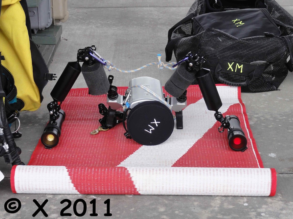

  9. I have now purchased two of those lights and used them enough to be able to report about them.
    First, a quick look at the way I am mounting them on my housing:
    I am using a ball-to-L&M handle adapter and two ULCS arms on each side (one large buoyant arm and one standard one with additional large Styx float). That's an expensive setup (I had it already) but I don't think the flexible arms used by peterbkk with his Sola 1200 would have been sturdy enough for those relatively heavy lights. On the other hand, I don't have any positive buoyancy issue. If anything, the whole assembly is a bit negatively buoyant (and front heavy obviously).
    The rope in between the two arms is just to prevent unwanted extension of the arms and is a safety feature in case one of the handle attachment gets loose (or breaks), which I hope will never happen! The other rope with a piece of tubing around it is what I instruct the DM or guy helping on the boat to handle the housing with. It is wrapped around the base of the housing handles and clipped to itself on both sides using quick release clips.
    I like the way the light output level is controlled: a ring on the front of the lens allows switching between 3 levels + off and is very easy to manipulate (butter smooth really). It's not as convenient as having control from the handles, but that's not available with the Sola 1200 either, so...
    Since a key element to the performance of the lights is the front lens, I tend to be a bit worried that it will get scratched or banged up in the rinse bucket, so I always have a color filter on each light when I don't use them (red on one and yellow on the other on this picture), which I flip back when I dive. They are just slid on the front part of the light and held by the friction of two o-rings, but I have already lost one in a rinse bucket, so I will need to find a way to secure them a bit better (or leave them in the rinse bucket).
    The light output is very uniform, bright enough to light up your subject from several feet away (and in fact too bright from a few feet away at full power). I still need to get used to the fact that the light distance and orientation needs to adjusted when the distance of the subject is changed significantly. But I am definitely very happy with this setup. Videos will soon be viewable on my YouTube channel...
    Now a note of caution is warranted: I have noticed that after each dive (be it in a relatively shallow pool or after 20 min at 90'), I always find a tiny drop or two of water in between the two O-rings that form the seal in the light head (and in fact at the back of the light too, where the battery is installed). I am monitoring that to see whether it will get worse. There is still a second O-ring to pass to become a real problem, but the bottom line is that I recommend checking this after each day of diving carefully (and taking good care of the O-rings).
    This is actually pretty much a natural thing to do, since the head needs to be opened to recharge the light. I have found a way to prevent this to be a dust hazard: I put the light body in a zip-locked transparent plastic bag with a single hole in it, through which I introduce the charger connector.
    Charging is actually relatively fast (there is a faster mode, but it is supposed to reduce the battery life, so I avoid using it) and the battery lifetime seems to be sufficient at least for a 3 dives day at full power. Again, it is very easy to turn down the lights when unused, so I suspect that more dives could possibly made on a single charge.
    I hope this information can be useful for others. BTW, the light package comprises a wrist mount so that the light can be used as a dive light as well (a bit long for that, I would say).
