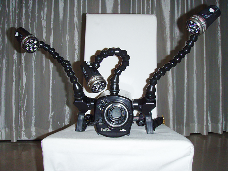

  1. Earlier this week i collected 3 x Sola 1200 video lights from my friend David at ScubaCam here in Singapore.
    After the first 2 dives with them, I thought I would share my experiences, updating this thread over the next month or so as I use it more often.
    Two of the lights are mounted on loc-line flexi-arms on the top of the Bluefin Pro control arms. The third light, on a slightly shorter flexi-arm is mounted on the top of the housing. Photo of the lights, setup in a macro configuration below.
    Firstly I tested a full cycle on full power in the sink at home. Lasted about 63 minutes, some 7 minutes short of the advertised 70 minutes. I expect to get slightly longer burn times once the batteries have run a few cycles. Also will get longer with a more normal on-off pattern of use. But all seemed well so I took them diving.
    Now, for convenience sake, my two test dives were at Palau Hantu off Singapore's southern coast, in a murky sea surrounded by oil refineries, land reclamation projects and one of the busiest shipping ports in the world. Visibility on a good day is 3 meters. More typical is 1 to 2 meters. But the area does have a huge macro population including nudis and seahorses. Enabled me to test the lights down to 14 meters, just to make sure that there are no flooding problems.
    My tests showed that:
    • none of the lights flooded!
    • running the lights on a mix of full and half power, the batteries easily last 100 minutes over two dives, and longer
    • the light is bright and, with 3 of them, give a broad even coverage (need to test later in WA conditions)
    • the light color is clear and white and very constant
    • easy to operate and, with a bit of practice, easy to set to the right output
    • three lights give a lot of flexibility for positioning, enabling macro lighting in awkward places and allowing trucking shots without losing light coverage
    • setting up the lights on the housing takes just a few seconds
    • taking the lights off the housing is also fast, enabling you to switch to a waterproof surface camera in a minute, depending on which port is on the camera
    • not having battery pods and cables is convenient
    • arms and lights fold forward under the front of the housing handles for easy handling when not in use
    • significantly lighter and more convenient for travel than any previous light system I have owned
    • chargers are universal, small and light
    Lessons learned:
    • without the battery pods the housing is now a bit top heavy. Not a problem for handheld but not good if I want to put the camera down. I will make a lead-shot pouch and use some straps to hold it under the housing to move the balance lower.
    • need to drill a small hole in the loc-line at both top and bottom to get the seawater out more easily.
    So far very impressed. Looks like L&M have kicked a big goal with this light.
    Early January I will take the camera and lights to Lembeh and Bunaken so I'll update this review after some intense use.
    Regards
    Peter

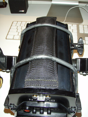

    Today I solved both the issues described above.
    I bought a 2lb bag of lead shot pellets, then went to a market in Singapore where they make and sell military stuff - belts, uniforms, pouches, etc. I got an old chap with an ancient Chinese sewing machine to make me two long tubular pouches, the same length of the housing, using 4" wide webbing. Once sown on 3 sides I filled each one with 1 pound of lead pellets and then he sewed them shut. So now I have two soft tubes, each weighing 1 pound. Then I drove to another market that specialises in industrial tools and equipment and went to a shop that sells o-rings - as sizes from tiny ones to huge ones. We measured and found that a 139 x 6.99 o-ring just stretches enough to fit tightly round both the housing and the lead pellet tube. Voila, a perfectly balanced housing. I need to check it in seawater to see if 1lb is enough (one tube down the middle, under the housing) or if I need to use both tubes (underneath, side by side, where the battery pods used to mount). I suspect one is enough. See image below.
    For the loc-line, I popped into ScubaCam and David neatly drilled a small hole in the loc-line at the top and bottom to allow seawater to drain easily for flushing out the inside of the loc-line tubes.
    While he was doing this, he also had a bright idea to run a strong fishing line down the inside of the loc-line from the screw that attaches the loc-line to the light, down to the screw that attaches the loc-line to the camera mount. In the event that I ever manage to accidentally snap open the loc-line underwater, the fishing line will prevent the light from sinking into the depths. The fishing line is completely internal so does not impact appearance or operation in anyway.
    Regards
    Peter

  13. The wings act as a stabilizer for much smoother (and slower) pans. One must remember that water turbidity plays an important part of how you place your lights, lest you want that junk lit up by the sides of your frame. Short arms/wings work very well in clear water, but not so in dirtier/higher turbidity water. The principle is the same as strobe placement. It's for esthetic and practical effect.
    Pete, won't your housing be unable to sit properly with that design? Wouldn't it be better to just use float arms to negate the -ve buoyancy of the light?
  14. Pete, won't your housing be unable to sit properly with that design? Wouldn't it be better to just use float arms to negate the -ve buoyancy of the light?
    The lights are not very -ve.
    I have yet to test the handling with my new "cosh" weight.
    I thought about using float arms or a block of foam on top of the housing but that could make the whole setup slightly positively buoyant. I do like a housing to be negatively buoyant.
    • Up to a point, I find a negative housing to more stable, as long as it is not so heavy that it tires arms and wrists.
    • When not in use I clip the housing to D-rings on my BP/W and I like it to hang firmly in my belly region.
    • Occasionally, I like to do shots of shy creatures by placing the camera on the ground and swimming away. With the weight, I'm going to have to find some rocks to prop it vertical but the weight is required to stop it wobbling.
    I'll see how it works on a couple of dives and, if not optimal, I'll look at float options.

    Just tested the Fathom 90 and the 3 x Sola 1200s in the swimming pool at night so I could judge the light coverage.
    The coverage of the Fathom 90 at full wide angle with the 3 Sola 1200s is excellent.
    I used a flat swimming pool wall with my daughter swimming past as the test. It is a tough test because in the sea you never encounter a flat even wall that you need to cover evenly with light. But, the 3 x Sola 1200s give good smooth coverage of both the subject (my duck-diving daughter) and the background (swimming pool wall). Even at 3 meters back from from the wall I was able to get even, corner to corner coverage. Back from the wall about 5 meters, some corner light drop-off could be seen on the wall but the subject was still fully covered with light. More than enough coverage for any real-world requirement.
    Turning off any one of the three lights and I was still able to get even, corner-to-corner coverage up to 2 meters out from the wall. Of course, one light by itself can not cover the Fathom 90 at full wide angle. Had to zoom-in to get complete coverage.
    I also did some trucking tests, to see if dark zones would appear when moving from a distant shot to a close-up. By having the outer lights slightly up-and-out and the centre light straight ahead and slightly down, I could truck the camera from 3 meters to 0.5m without shadows appearing.
    Looking forward to getting this system out to Bunaken in early January...
