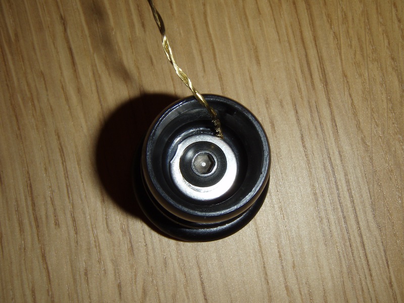

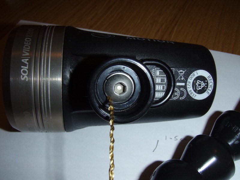

    I came to the same conclusion. I figured that it might be possible to snap open a locline arm and lose the light-head, for example, when struggling with a strong current on an ascent line...
    So, I bought some strong brass picture-frame wire (no rust). It runs invisibly down the centre of the locline arm and wraps around the screw-head that holds the locline arm to the light-head and, at the other end, to the housing mount. The wire is about 2 inches (5 cm) longer than the locline. Invisible but adds some protection.
    I have not yet, after about 50 dives, snapped a locline underwater but I have done it accidentally in the rinse tank. The brass wire worked.
    Photos attached.
    A friend of mine who works in the aircraft industry is looking for a stainless steel "figure of eight" washer so I can replace the "brass wire loop around the screwhead" with a better engineered solution of attaching the wire.

  17. So, I bought some strong brass picture-frame wire (no rust). It runs invisibly down the centre of the locline arm and wraps around the screw-head that holds the locline arm to the light-head and, at the other end, to the housing mount. The wire is about 2 inches (5 cm) longer than the locline. Invisible but adds some protection.
    Great idea Peter. I will be getting some new Keldans soon and will do the same thing. However, like you, I have never had a loc lin attached light ever come off, even in some horrible currents in Tahiti.
    Steve
  18. So, I bought some strong brass picture-frame wire (no rust). It runs invisibly down the centre of the locline arm and wraps around the screw-head that holds the locline arm to the light-head and, at the other end, to the housing mount. The wire is about 2 inches (5 cm) longer than the locline. Invisible but adds some protection.
    Steve
    Hi Steve,
    A bit of extra insurance never hurts. I have snapped the locline in the rinse tank so I know that the system would work in practice. But, it is also important to check the screws that hold the arms to the housing as they are not long and, if they work loose, could also come off underwater. I use a drop of loctite to secure those screws.
    Regards
    Peter
