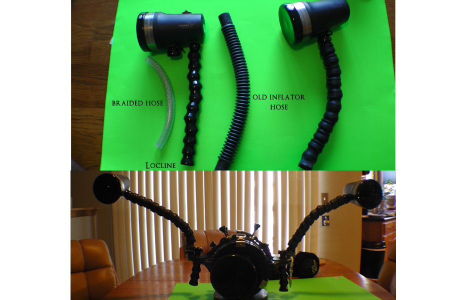

  17. In regards to continuing this subject I just rigged something up that appears to address the "flop" issue. Attached is a pics of a "before" and then an "after" showing the 2 Sola 4000 spread out. Instead of steel cable to secure the units to the arms and the arms to my housing ...I used cave line.
    Basically, I used a plastic braided hose for the locline insert (to minimize how much "flop" they had) then used a couple old inflator hoses for the exterior cover as a redundant way to keep everything together. Since most of what I shoot has a scooter attached to it I need to minimize how much movement the arms have yet remain pliable enough to position at various angles. After a quick trip down the hardware aisles this seems to be the most simple solution I could come up with.
    For what its worth...
    Don
  18. Good idea Don. Does that stop the creaking too?
  19. Nick,
    Unfortunately it doesn't address the creaking issue...
