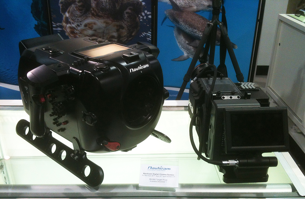

    I can't really see it happening with Gates now. At the top end they seem more interested in broadcast spec cameras. In a way the FS700 is already starting to feel a little old since the much improved ergonomics etc. of the F5 and F55. I can imagine an improved replacement for the FS700 in the not too distant future. Maybe Nauticam could step into the FS700 housing void since they're already dipping their toes in the water with the RED housing.
  13. I had a look at the Nauticam prototype housing for the RED, looks very interesting. My one concern, is there may not be enough air space inside the housing for the camera's cooling fan to do its job efficiently, as this camera can generate heat even in standby mode.
