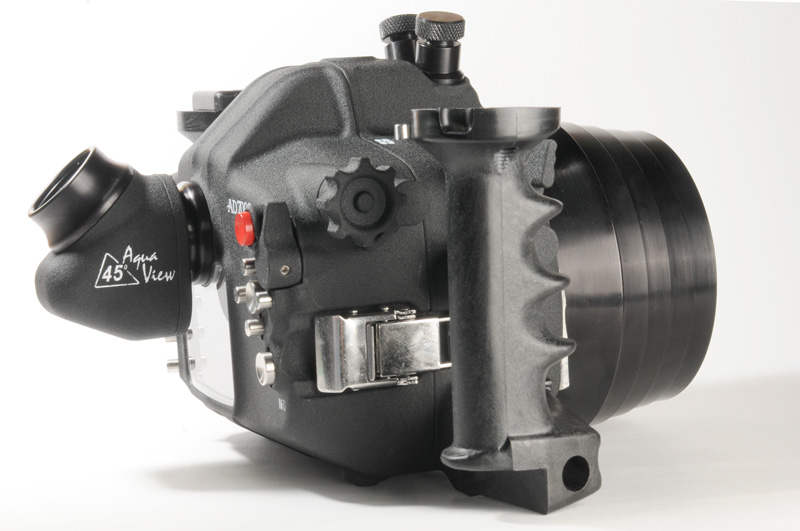

  9. ...I'm not familiar with a viewfinder. How does it work? Do you have a link I could look at?
    Scroll toward the bottom here - there's both 180deg (straight) and 45 deg viewfinders.
    http://aquatica.ca/e...dslr_d7000.html
    (Hope the supplier link is legal - I'm not associated with them and don't even own any of their products, just trying to help the guy asking the question).
    The viewfinder helps you see thru your mask, same as the little magnifying 'bubble' on the back of the Ikelite housing you've got now, but with considerably better and larger optics (and, in the case of the 45 deg, helping you keep the camera low to the subject while not crashing your body on the reef or breaking your neck to do so).
    Inon also sells one which can be retrofitted onto Ikelite housings, as does I think Dyron*. So the VF isn't going to lock you into choosing Aquatica.
    (*Actually Dyron's might just be an Inon with an external coupling. Another board member here - blibecap of "UWCameraStuff" - also retrofits them into Ike housings but directly to replace the existing 'bubble' optic vs. an external clamping ring that might come off with rough handling.)

  10. Scroll toward the bottom here - there's both 180deg (straight) and 45 deg viewfinders
    I recently added a 45 deg viewfinder to my Aquatica rig and love it. I was able to go to the Aquatica office when I was in Montreal last winter and was able to fondle both. I found the 45 to be much more compact and saved a lot of neck twisting. There's a lot of discussion about these things elsewhere, but a common comment was that the 45 takes some getting used to, and I will echo that. I dive every week and manage 3 or 4 trips a year as well, and I have become comfortable with it, but it did take a bunch of dives. I still occassionally poke myself in the mask with it, especially at night!
    It has really helped my framing and composition though. I rarely crop a photo since I started using it...

  14. Off course it is legal, and I would go further and thank you for using it as a reference. This link is actually more direct http://aquatica.ca/e...s_aquaview.html
    OK, I get it now.
    I've always used the screen liveview. Why would you now just use that?

    Question 2.
    DSLRs don't work the same way as P&S/Mirrorless cameras. They use separate sensors for autofocus, these sensors do their jobs extremely well and extremely fast. Faster (for now) than what most P&S/Mirrorless systems claim they can do. So if you use live view then you will be relying on the slow contrast detect AF rather than the dedicated phase detect system of DSLRs. A DSLR doesn't do Live View anywhere near as well as a P&S/Mirrorless camera.
    The big viewfinder (I have the Aquaview myself) is almost akin to composing your image using an IMAX screen vs a regular movie screen when through the standard finder. You can of course do it well with the standard finder but if you make the "mistake" of looking through the big VF's, you won't be to happy going back to the standard VF.
    S.

    Regarding the external viewfinder it needs to be seen to be fully appreciated. To be able to see more of the frame allows more precise and accurate shooting and once you use one there is little going back.

  18. I recently added a 45 deg viewfinder to my Aquatica rig and love it.
    I have the straight viewfinder and am thinking of changing over to the 45 degree viewfinder.
    Does the 45 degree viewfinder block the viewing angle of live view to the same extent as the straight viewfinder?
    I always focus with the viewfinder for still images, but am starting to experiment with video and find the straight viewfinder too obtrusive when shooting video with live view.
  19. Paul, the 45 degree finder out there all have a pot belly hanging out, it is the nature of the optical design, here is a picture to give you an idea. on the plus side, it can be rotated to present its thinner side (as you would for shooting vertical) when shooting video. then it should no more obstruct the LCD than any straight view finder would.
