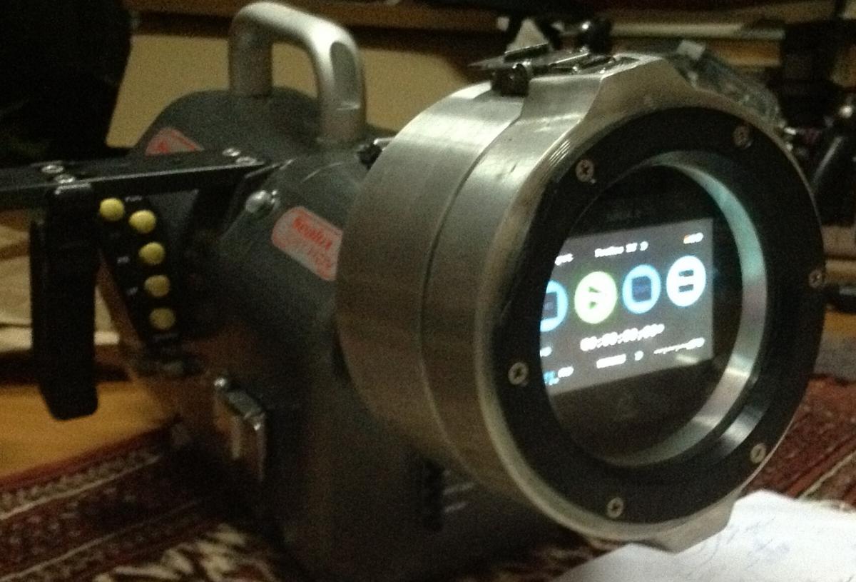

  7. Here is the second major milestone in this project: Inventing a Ninja II housing.
    I hope the attach photo is shown correctly as I am posting through iPad (iOS 6).
    The Ninja II which uses HDMI is working beautifully with FS700.
    Regards,
    Thani

  10. Separate cables for HDMI and LANC sync?
  11. Yes separate cables. LANC to control the camera and HDMI to trigger recording on Ninja II which is unlike the previous Ninja has no LANC cable.
  12. That housing for the monitor is a beast!!! What is it made of? Great work, I would love to see some footage captured via the ninja.
  13. The Ninja housing is made from an aluminum cast.
    They actually sculptured (machined) the cast. Despite the size it is actually a tight fit.
    The monitor housing is composed of 2 main parts:
    a) The front which obviously has a glass and a clip-able aluminum frame &
    B) The back main body which has a screwable end that goes into the original view finder place.
    The plan is to do a test video dive next weekend - not this coming one.
    Sultan will be posting the video later. I hope the plan comes true
    Edited by thani

    Seriously though, it looks way too big to be practical. The Ninja housing could be a fraction of the size/weight if it was machined out of a solid block of aluminium or delrin to fit the shape of the Ninja. Also, having a separate cable linked external monitor would allow better ergonomics and positioning for viewing at different angles (not to mention transportability).
    Edited by HDVdiver
  17. It felt just like we were seeing Jacques Mayol in The Big Blue, surfacing with the world record.
    The "Okayyy" shout comes from the guy who made alot of effort into the manufacturing processes. smile.png
    Transportability: Is not an issue hence you can unscrew the monitor housing from the main housing.
    Ergonomically: I agree that it might be difficult to use in certain setuations.
    Size: Width-wise, you can not make it less wider hence it is a tight fit. And the HDMI out is on the side of the monitor, does not help a lot.
    Guys remember that we do not have the tools to do it better.
    Come on guys, give us a break. We are a bunch of hobbyists executing this challenging project.
