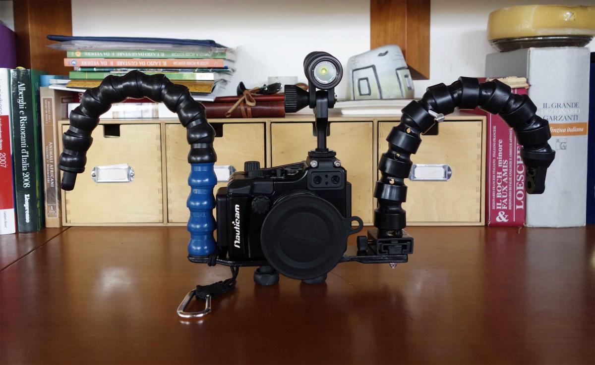

  16. Actually I also don't have arm on the right side, so left hand on the arm and right hand on the housing. So for sure the front lens dial on the Recsea is not efficient. I hope Sony will have a firmware update to allow tweaking the sensitivity of the front dial so manual focus is more useful. Or maybe quick adjustment in normal view and fine adjustment in zoomed view?
  17. About the right arm:
    It is possible to use all the Nauticam controls if the arm or the handle is in contact with the right side of the housing (not for small hands).
    I made a custom tray using a scrap of 3mm Dibond (doubled to have 6mm thickness) : a perfect material for underwater DYY.
  18. About the right arm:
