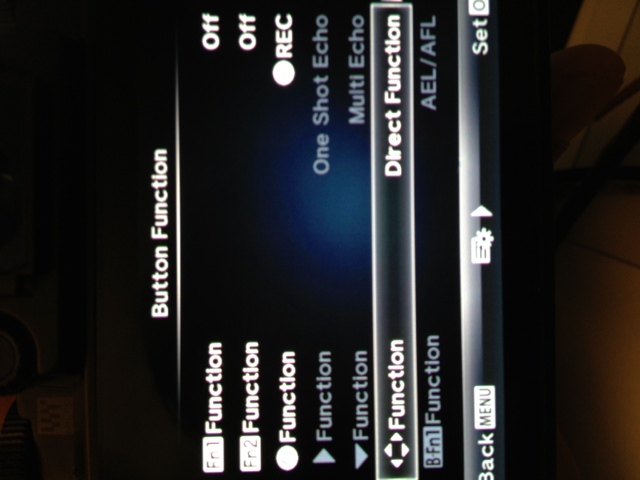

  16. Hi,
    The [>] Function button of my camera is grey out in movie mode, thus it cannot be set to WB or ISO setting. Do you know how to fix this?
  17. The [>] Function button of my camera is grey out in movie mode, thus it cannot be set to WB or ISO setting. Do you know how to fix this?
    Set "<^v> Function" just below it to "Direct Function" first.
  18. I did set it to direct function. Somehow those > and v key are still greyed out... ;(
  19. Set Custom Menu -> I. Movie -> Movie Effect -> to "Off".
  20. It works now. Thank you so much!
