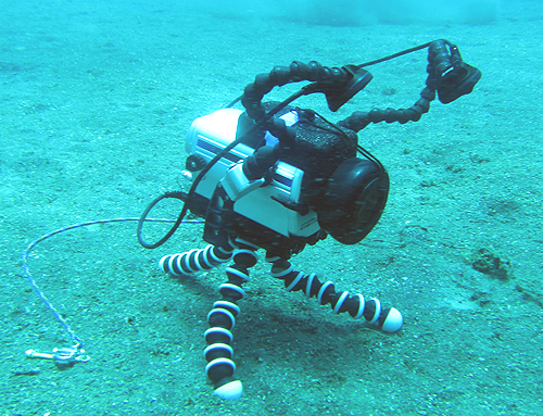

  2. Kaj, I think I have asked this before, but is your Gorillapod metal or plastic?
  3. I think Kaj's Gor.pod is plastic. I have exactly same one.
    Love to know if there are metal ones available. Marine grade aluminium and I'll take 10 please. May be I could just make one smile.png Any takers?
    David
  4. Kaj, I think I have asked this before, but is your Gorillapod metal or plastic?
    Yup, plastic, and the same one I've had for the last three years and it's still as tight as a ***** ***** (fill in the blanks as desired). Maybe all this dirty Lembeh water keeps it clogged up and stiff...
    David, the only difference is my has red markings all over it, not sure if that means it is a different model...
  5. Mine has white borders. Same size but different paint job :)
    This may sound contradictory but by using the G. pod everyday you actually keeps it in good shape as the salt water does not dry up between the joints. I have not use my for over a year and I could harvest a tea spoonful of salt from mine...LOL

  10. Love to know if there are metal ones available. Marine grade aluminium and I'll take 10 please. May be I could just make one smile.png Any takers?
    I don't know about marine grade, but the Gorillapod Focus has "machined aluminium sockets" in its legs. And it costs twice as much as the all-plastic Gorillapod SLR-Zoom.
    (Just to recap, I bought a load of Gorillapod SLR-Zoom a few years ago and modified it to use as light arms as well as tripod legs. They have all gone floppy and now more joints are superglued up than aren't. It sounds like others haven't had the same problem.)
  11. I don't know about marine grade, but the Gorillapod Focus has "machined aluminium sockets" in its legs. And it costs twice as much as the all-plastic Gorillapod SLR-Zoom.
    I use both (SLR-Zoom x 2, Focus x 3ea) and same problem with SLR-Zoom but Focus still doing fine.
    btw, Focus is negative and SLR-Zoom is slightly positive.

    Do you think it would be possible to buy 2 x Focus, dislocate the joints, and make a double-length legs? (I did this with my SLR-Zoom)
    Would the Focus be rigid enough for that, or better go with something like Xit 404 or DIY legs using strobe arms?
  14. Do you think it would be possible to buy 2 x Focus, dislocate the joints, and make a double-length legs? (I did this with my SLR-Zoom)
    I didn't try that but might be possible but I think you need something like "Loc-Line Assembly tool".
    Anyway for video rig, I recommend Xit 404 twist clamp leg, ultralight tripod leg or strobe arm (if you don't need extendable).
