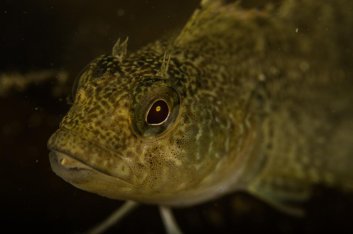

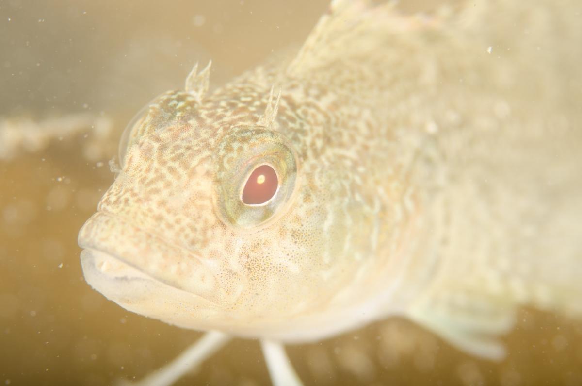

  1. Hi. I’m just learning. Where I live the visibility is currently bad (3 ft) but I am going out anyway to develop my skills.
    In my earlier attempts I wasn’t really getting any colour and couldn’t get sharp photos and I figured that it might be to do with ambient light (shooting in 3 ft of water). So this week I took both strobes (DS125’s) and put them on 1/2 power. I am still getting washed out looking photos but after tweaking in lightroom I’m much happier with them.
    Have read in the underwater photographer that it is better to take the shot overexposed and darken in lightroom in order to get more detail so was kind of trying to do that. To me the actual photo looks way overexposed, but the histogram doesn’t?, and the photo doesn’t seem to have any blown out detail. My questions:
    Am I doing this right?
    Should I be aiming for a better exposure out of the camera?
    Is this possibly anything to do with strobe positioning?
    Any comments general on how to improve this shot?
    I’ve attached the photo as shot, histogram and the photo with exposure/contrast and clarity tweaked but nothing else. D7000, 105mm lens, 2 x DS125’s. ISO 200, f16, 1/320th.

  2. In my experience you get that milky look when your strobes are pointing directly to the subject, if you angle slightly away to hit the subject with the sides of the strobe light then it should look a bit clearer. You may find in doing that the pics become underexposed, however you still have half your power to dial up....
  3. Any detail that is blown away by over exposure can't be recovered so it is generally safer to underexpose by 1/2 stop. LR will do a much better job of recovering dark areas.
    A good starting point is to process in LR to maximise the spread of the histogram (exposure & black sliders) then if necessary adjust fill light or recovery to taste. Failing that start playing with the tone curves or region sliders. A touch of the clarity slider seldom hurts. All post processing works much better with raw files.

  6. Don't underexpose, since you loose tonal information and increase noise.
    The Picture is overexposed, but the highlights are not blown out. Therefore, you can still correct it in Lightroom.
    I would be aiming for a better exposure with perhaps a slight overexposure ( atleast no underexposure)
    When the visibility is really bad. Set the Strobe Power as low as possible and think about how to aim the Strobes, to avoid Backscatter.

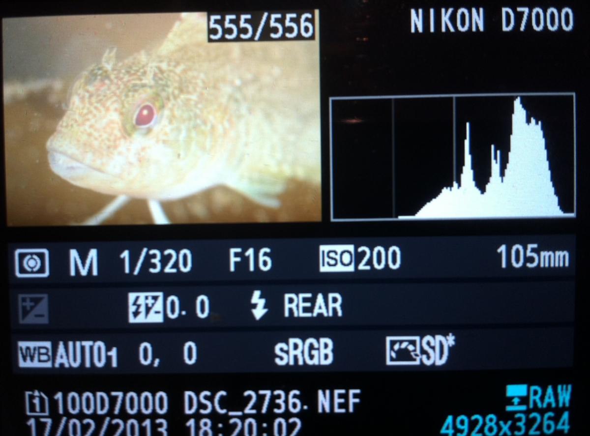

    Steve I checked my camera (D7000) and it is set on "Standard". I should have mentioned that I shot in raw - so does this setting matter? I have also attached a photo of the camera's histogram - could I have actually given this more exposure?

  10. Judging the Camera settings and the Histogram. I would say that your Strobe Setting is a too high ( f16, 1/320s & ISO200 should make it pretty dark without Strobes).
    I would personally reduce the flash Power stepwise until you get a result that you are happy with ( perfect exposure or a wee bit of overexposure, but no blown out highlights).
    Well, I start with a minimum Flash power setting and increase it until I like it. A small amount of Flash helps also against Backscatter.
    Rear Curtain does not really make a difference in this Pic, since it has no movement. The Strobes are syncing anyway. So, it should be no problem.

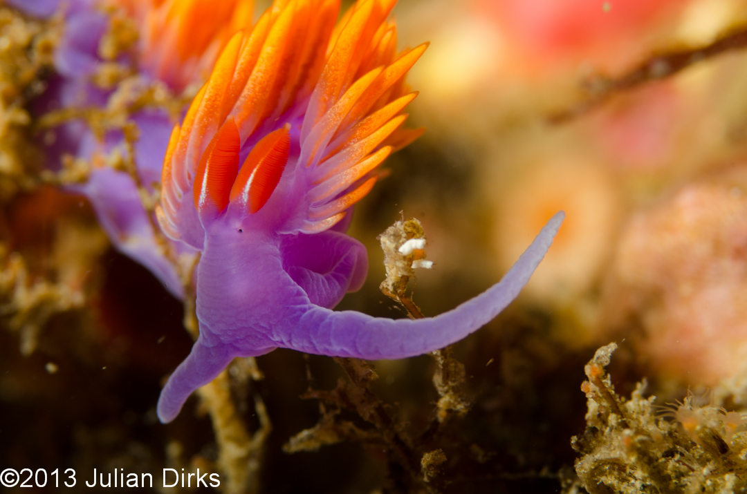

  16. Well, I got out to Santa Cruz Island on atrip with bluewater photo and with the help of you guys and a few pointers from some people on the boat I got some images I'm really happy with. In addition to having a high power setting I think I also had my strobes too far forward. Here's one of my favourites - as shot.
    Thanks again for the advice.
    Julian
  17. Super Julian!!
    The only little thing I would add is that in this case I would have gone for a vertical composition so as to get all the nudibranch in shot.
    Dont be afraid to move your camera around to improve on the image!!
    Otherwise...well done!! Lovely focus and colours!
  18. Very nice - it looks like you've really applied everyone's advice. Good job.
