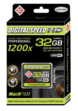

  2. Purportedly this 32GB card should go up to 160 mbs... I am just happy if it could sustain 120mb in my 5D MIII. May be 1080 @ 60p is a near possibility.
    At USD 600 a pop. Ouch. I heard rumors that Komputerbay is also near production of 1200x 32GB. Come on I need a 256GB @ 120mbs constant speed. I would be happy to fork out dosh for that.

  3. David,

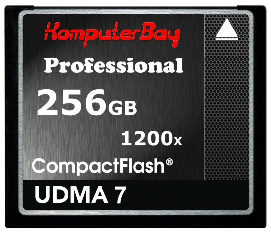

    I've been told by my industry guy that the MLC chip yield for 1066/1200x have been low, too low to make it happen. However, they have a lot of unsold chips someone very enterprisingly bought up to make the Komputerbays and Digital Speeds. Both of these companies are selling 1200x 64-256GB, claiming 140+MB/s write speed.
    They are all over Amazon now. Would you pay $699.99 for a Digital Speed 64GB 1200x, given that they sell through 3rd party sellers on Amazon including Brooklyn scam stores?
    UDMA 7 has a limit of 167MB/s as a standard. I'm guessing that the chip manufacturers are having difficulty sustainably making good enough chips for the Lexar/Sandisk crowd, and being enterprising people, are selling off the rejects. That's why Lexar/Sandisk/Toshiba etc haven't announced anything more than 1066x.
  4. 1200x 64-256 ???? - where did you find that?
    Highest capability scam (allegedly) CF cards I found in Amazon is 64GB
  5. So this is a scam?
    I'll wait until someone test this card. I am happy if this could do 120mbs sustained speed.
  6. Not so much a scam as a way to make money off rejected chips. It's written off so they can get them @ lower cost. The CF casing and UDMA 7 chipset are cheap. Think about it... UDMA 7/CF 6.0 is maxed out @ 167MB/s as a standard. So a NAND chip that is faster than anything on the market AND is cheaper than what the real competition are by over 50%??
    There are bridges which are cheaper! :)

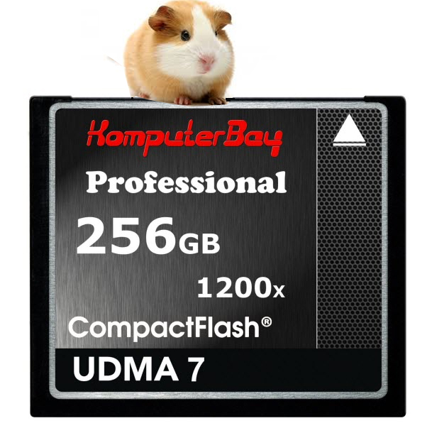

  7. So who's going to be the Guinea Pig???

    Now all I have to do is get a few more 64GB 1000x Komputer Bay CF cards. Just for information the fabled 1200X card did not go any faster than the 64GB. It could however allowed for longer recording. I will wait a month or more until the price drops.

    David, Komputerbay is very unreliable. Would you use it on a work shoot? The 3 I ordered have all died, replaced and died again. It has a high failure rate. I'd wait for Lexar, Toshiba or Sandisk to launch their 167MB/s cards.
  17. Yeah I know about Sandisk but waiting for price to drop. I think 120mb/s is more realistic as the 5D MIII buffer maxed out at the moment at 110 and constant at around the 90s for continuous RAW HD. The ML boffins will look at increasing every last ounce out of the camera.
    My Komputer Bay 64 is still working after three months. Getting a few more. Good thing is they will replace it.
