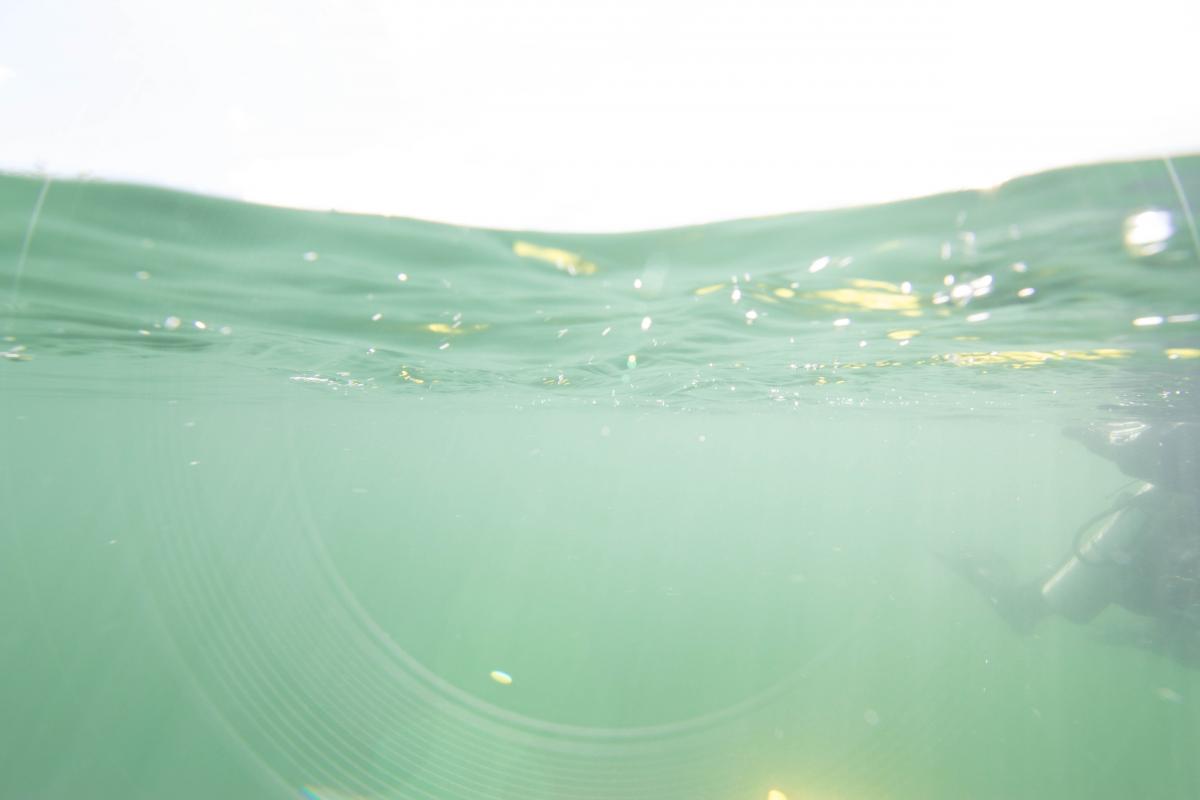

  10. This thread is interesting to read. This is one of my first photos (straight off the camera and downsized) from an outing with my Canon 5DII in Sealux housing. You can see the diver is being cradled by rings.
    I deduced quickly that these were the rings from inside the dome, and that their appearance is related to aiming at the sun. I can try the black gaffer tape trick too. In the end will it be a case of working out at what shooting angles to the sun these appear and then avoiding that?
