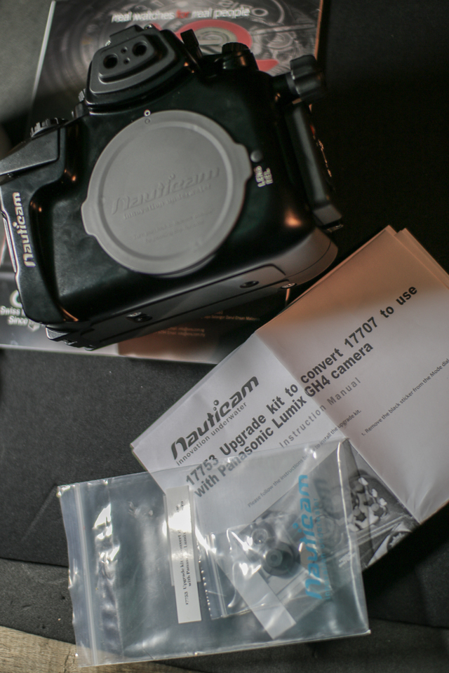

  13. NA-GH3 Upgrade kits for gaining use of the command dial with the GH4 are now with Nauticam dealers.
    Expecting my upgrade kit end of next week. Will report back with how it does
  14. This was dead simple, only need change dial mode rubber pad (took 5 min).
  15. Cool!! Looks more than just the rubber pad - is it the holder also?
    Any chance you can scan / take picture of the instructions?
