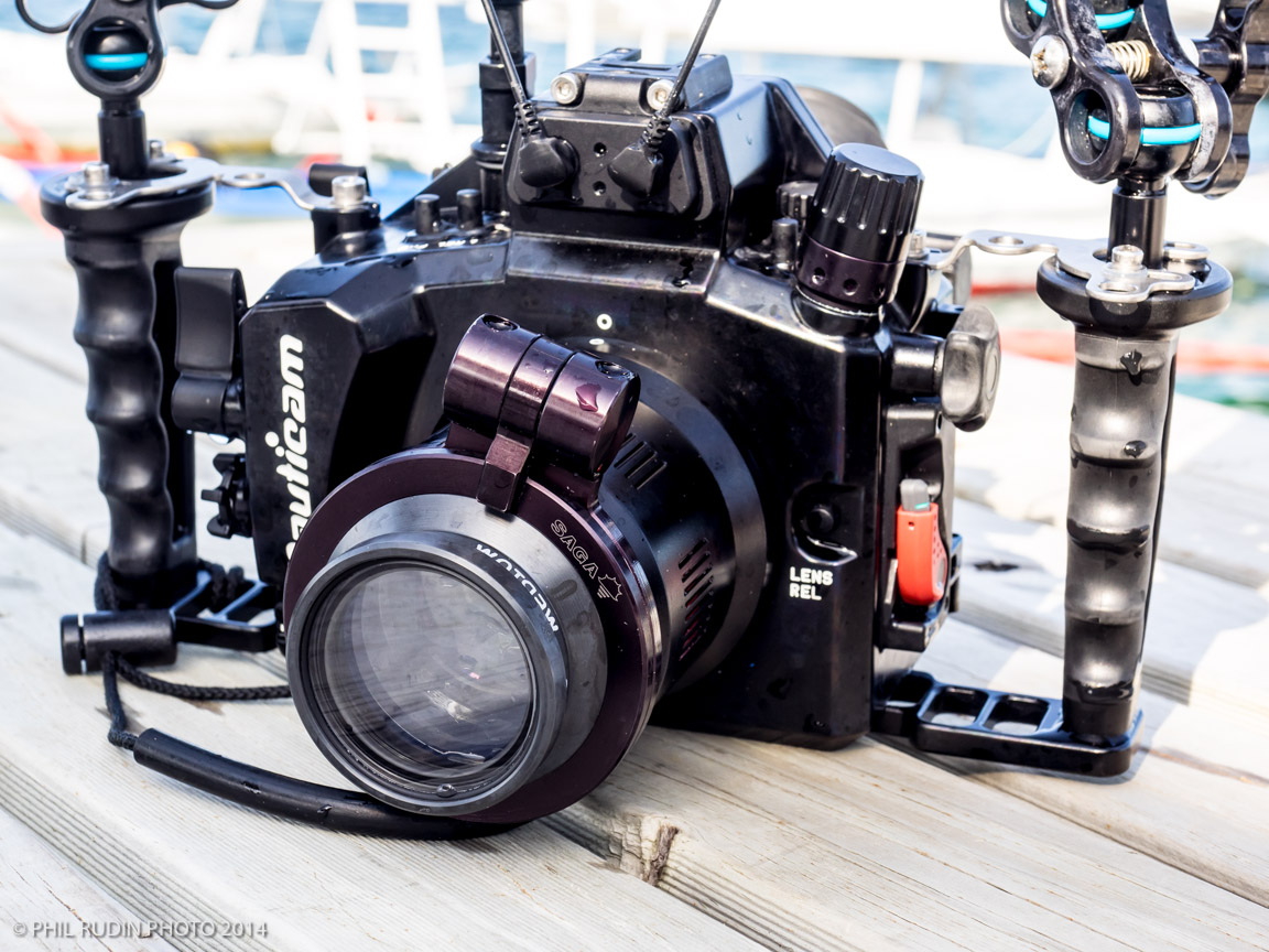

    Carlos, you are an excellent photographers and put the fisheye and 7-14 to great use so this may not be a big issue for you but some consider the 12-50 zoom to be the holy grail of all purpose lenses for the M43 system. If you intend to use this lens with the macro feature locked at 43mm) you may want to know if Aquatica intend to support its use because it is a quite complicated lens to support with all of its features. To make it zoom from 12 to 50mm is not hard only getting it to lock in the macro mode is a nightmare.

  6. The issue with the 12-50 zoom is the complex gear required for shifting from the 12-50 power zoom into the macro mode. If you want to make that work it requires a custom port and gear. To get the lens to zoom from 12 to 50 in the Aquatica dome is not the issue, gears already exist for that and the E-M1 camera can be programed to zoom this lens. Getting it into the macro mode is quite a different issue.
    A little information on the lens and how the gear which allows the macro feature works.
    http://www.reefphoto.com/kb.php?id=45
    http://www.reefphoto.com/kb.php?id=41

  10. Several after market gears are out including the one attached. The problem then becomes if you intend to shoot the lens behind a dome without the ability to attach a closeup lens or will you want to shoot behind a flat port so that you can use the closeup lens. I think you should be able to use this lens in the Aquatica port for the 60mm macro lens since both lenses are about the same length. I use the 12-50 in my Nauticam 65 port for my 60mm macro, both ports have the 67mm thread for a flip adapter and/or closeup lens.
    http://www.deepshots.co.uk/2014/04/introducing-missing-bits-by-deepshots/
  11. Yeah, is my idea, work with the flat port for both lens, 12-50mm and 60mm
