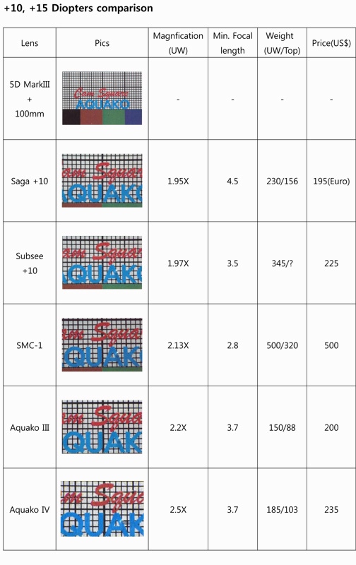

    Have you heard about those Aquako 1,2,3,4 ?? (Korean brand)
    Apparently Aquako 3 is similar to SMC and Aquako 4 have more than the SMC...
    But if you add the Multiplicator to the SMC... That might be really lot more magnification...

  13. I have Oly, Subsee, Saga and SMC wet lens. The Oly have great optics, but way too weak. You can stack them, but getting all the air out between them, making sure there is not particles, is a serious pain.
    The Subsee works, but I have the older ones and cannot stack them.
    The SMC is a joy to work with, easy to see, fast to focus...and pretty much all I use these days. One could stack them, but after the cost, boy would that be heavy.
    The saga is light weight, and the images don't look that bad, but these are "softer" lenses than the Nauticam, so when trying to focus or to view exactly what is in focus, these are harder than the SMC (which is a high contrast lens). Images look fine, just hard to use, would not want to stack them.
    That leaves the new guy on the block.Aquako..light weight, supposed to have higher contrast (will see).
    One of the concerns about stacking wet lenses is the resulting working space one gets and could one actually use all of that magnification (assuming one is at maximum). I know the SMC should work, as it seems to have a greater working distance than the subsee, but I would doubt a human would be able to see the object one would be taking images of. The attached image is with the SMC at around 1/3 power. Stacked and at maximum magnification, one would be looking at something around a 30x microscope...post-35824-0-82221600-1421827044_thumb.jpg
    Still don't have the perfect lens, so hope the Aquako is it.

  17. I just receive my Aquako IV and haven't tested it yet. Just wondering, if the new Nauticam CMC-1 is not as powerful as the Aquako IV?
  18. Reading Nauticam's review of the CMC, that is a very mixed bag. It seems if you are using say a Sony R100, the CMC may be stronger, but using a larger sensor camera, for the most part it would not be close. It seems to be an interesting approach, as it is not a simple diopter design. As this is focal length increaser, DOF will go down, working distance will go up on a small sensor camera. Bigger the sensor, the less it works, the more DOF effect will come into play. Own say a oly micro four thirds and there are far better options. Own a Dslr, and would not consider it.
  19. Thanks, I actually am using the Panasonic LX100. I know the big selling point of the SMC is sharp corner, no CA, and easy working distanct. Seems like the CMC-1 is offering the same feature. I haven't test the Aquako, so I'm not even sure if there is any CA issue or if it's difficult to use like the Subsee+10.
    Looking at the Nauticam CMC-1 chart, the LX100 yield 2.3X, but from the chart jojolcuisto provided above, the Aquako is 2.5x, on a 5DM3 + 100mm. So what does that mean when comparing the Aquako and CMC-1?
    I'm debate if I should spend $320 for the CMC to use it side by side with the Aquako.
  20. They both should be close...but different. The Aquako should have a little better magnification. The Nauticam should have better working distance. The Aquako should have better DOF, the Nauticam a bit less. Both should work, and it comes down to the focus issue. I know the SMC is a very high contrast lens, if the CMC is similar, it should do a great job of contrast focus. Aquako is an unknown to me..if it is good, then don't think I would go any farther, with one other reason...How good is the working distance with the Aquako? If it is too close, then would consider the CMC. As you have the Aquako, it should be easy to answer.
