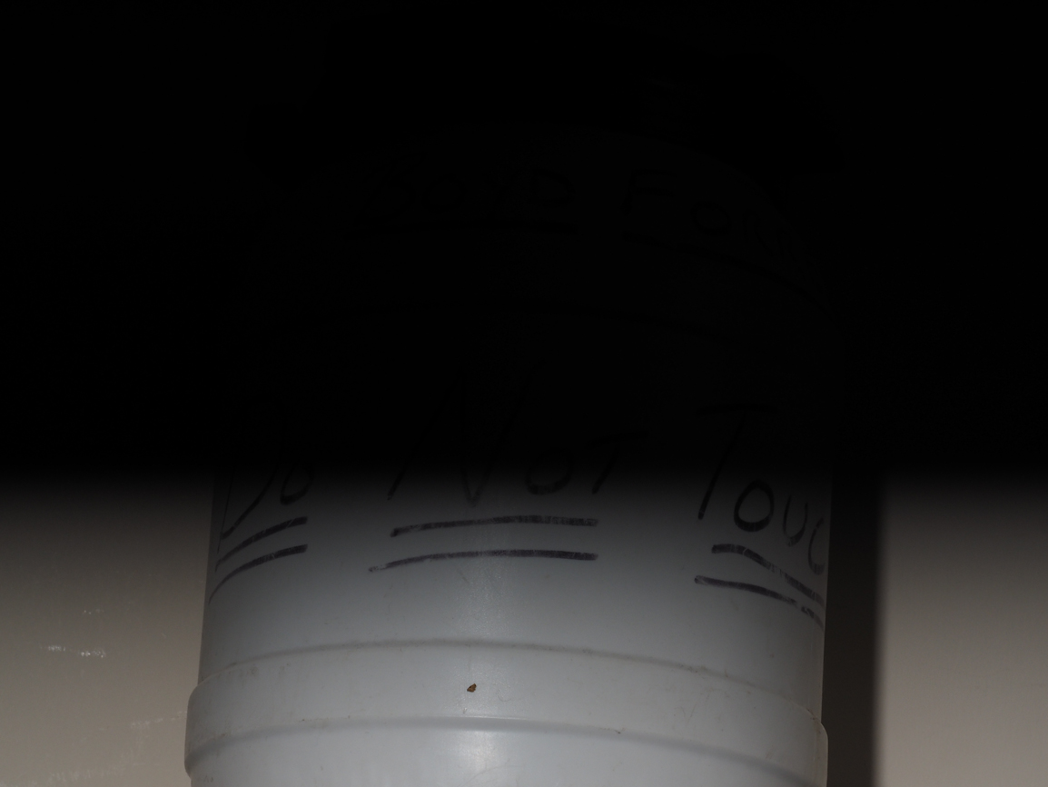

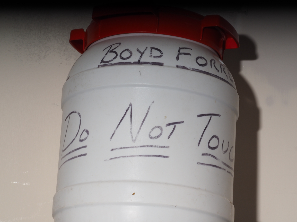

  7. ok guys what i have done is check a few things so here goes if you want full use of EV dial on ys-d1 when set to TTL you can have 1/320 but no higher f stop than F14 if you want F22 then no faster shutter speed than 1/160 here are a couple of photos first is F18 AND 1/200 next is F18 AND 1/250 the faster the shutter speed and higher the F stop the worse it gets

  8. Does the olympus have a no preflash mode? If it does i would try that with strobe in no preflash to see if you get a faster reaction?
  9. Hi the only way for the pre flash not to work is to put the flash on manual after that you only get 1 flash when flash fires.
  10. Yes do that and set the strobe in no preflash. Just to see if the ttl preflash is creating a delay
  11. Yes it works fine on manual always has done but if you want to use TTL after the setting i gave earlier the camera and strobe dont sync i.e 1/320 the highest F IF F14 and if you want to shot up at F22 then fastest shutter is 1/160 but on manual all is ok

  18. I have shot some images tonight in my living room at f22 in TTL at 1/320 with various exp comp on the flash from -1 to +1 and the images come out ok.
    Same seems to be the case for manual flash mode.
    SO far I can not find the same problem like you.
    On the other side I ask myself - how often do you need f22 with m43?
    It seems one needs to crank up ISO in the 1600 range to get proper exposure with the YS-D1 at that f-stop and medium distance (with FE-lens).

    I think he said it works fine at Macro distance and the problem occurs at medium distance.
    If you shoot f22 at medium distance you reach the limit of flash power of the YS-D1 if you stay at low ISO.
    Anyways- IMO the question is why do the OPs camera-flash-combo show a problem which seems not to exist whith my samples of the same equipment?
    Is it a) a defect piece of equipment (and if so is it flash or camera) b) is anything wrong with the settings c) does it occur to other people who use the same equipment
    OP - did you contact sea&sea and ask for an explanation? Thats what I would do for sure.
