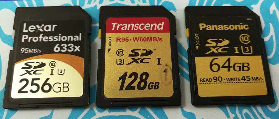

  12. Hi guys,
    Which type of SD cards are you using for 4K?
    Thank you in advance
  13. In the attached pic, the one on the left is in my underwater GH4 until it's full, then I put the older one in the middle in. The one on the right is in my topside GH4. Had no problems with any of them.
  14. I'm using the Transcend the same as Nick, got 2 of these for my GH4.
    Regards - Richard
  15. Thank you guys
