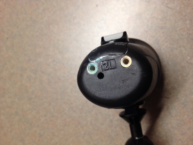

  1. My Sola 600 is not charging and I think it might have to do with the contacts as they are full of what looks like mineral deposits?? How can you clean these contacts?
  2. Based on my recent experiences with the Solas, the charger is working, right?
    If that's fine, it could be the charging contacts on the light. They do look in need of a clean. You might want to try and mix of white vinegar and water to start with. I've used that successfully to clean those types of deposits.
  3. Thanks guys
    I cleaned with some vinegar/water and its working normally again!
  4. Hi Lemur
    I'm delighted it worked. Good old Grandma... she was spot on! :mocking:
