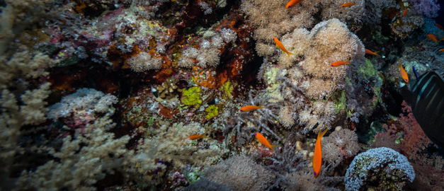

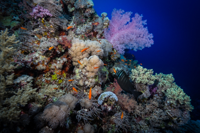

    Going through the images now on a large screen, I was surprised at how many of the WA shots had pretty soft edges. I'm using a Nikon D800 with the Nikkor 16-35, a Subal housing and, as recommended by Subal, the DP-FE4, a 90mm EXR and a +2 diopter. The diopter was straight on to the lens - I removed my usual UV filter first.
    I'm attaching two images. One shows the whole scene and one shows a slice. Check out the softness on the left edge especially. Camera was set at 1/60, f9.0 ISO 200 and the lens is at 19mm. I used two Inon strobes to light the reef. The centres of the images are nice and sharp. But the edges, not so much.
    I've upgraded from my D300 and Tokina 10-17mm and I'm still fairly new to the Nikkor 16-35 underwater. Maybe I'm expecting too much?
    Thoughts would be most welcome
  2. Nice image.
    All rectilinear wa lenses lose a bit in the corners, especially at the larger f stops. It's the physics of dome ports. If it really bothers you, crop or vignette in post. I wouldn't have noticed if you hadn't pointed it out.

  4. Try a +3 or +4 to see if that helps. Had similar issues several years ago with different setup. More diopter made a noticeable difference.

  7. I dunno, you shouldn't have to be using diopters at all if you have a large enough port. All you are doing is taking a great optics and dumbing them down, IMHO.
    I think the main issue is that the port is too small. Stopping down and adding a +2 helps a lot, but until you shoot that lens with a 9" port, I would expect corner issues. Shooting vertically, you can put two corners in the blue so it's not as apparent. But the Sigma 15FE or Nikon 16FE will shoot rings around the 16-35 for sharpness, especially with a smaller port.
    Rectilinear zooms are best used for big animals where you need a little more reach, than CF/WA.

    Thanks Jack, I was wondering if it was the size of the port. Depressing! I have been thinking of switching to an FE - but the 16-35 gives that much more versatility.
