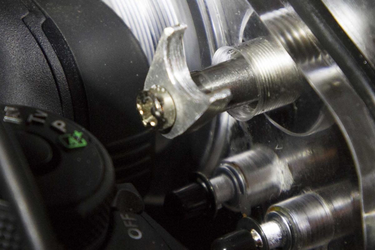

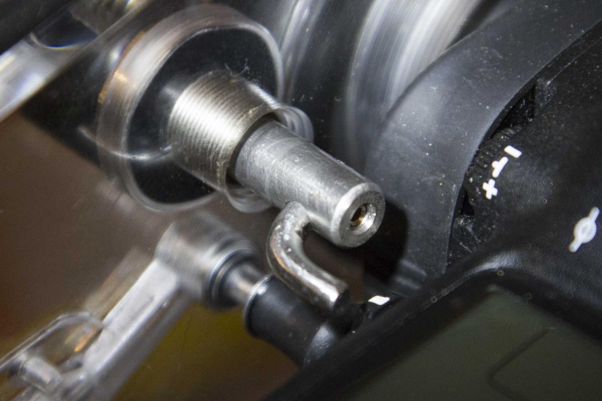

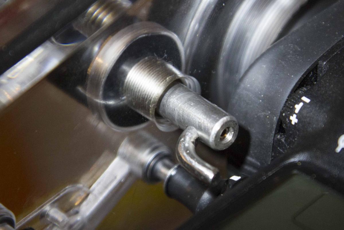

    I began the transformation. I have found three items that needed to be fixed in order to use the controls: on-off switch, left-top function knob, and the AF selection lever, which flips the mirror and goes to video mode.
    I purchased a foot of 303 stainless steel precision ground rod. The first part, the most critical, a two inch rod with an L-shaped lever attached to one end that actuates the selection lever. I chose not to modify the original as it can still be used for when I wish to return the housing back to a 7D.
    I read where the power on-off shaft was not long enough to reach the power switch. Adding washers won't help, the screw is too short and they used red locktite. Actually, it depends on how tight the camera is attached to the base plate, but so that isn't an issue, the shaft needs to be longer. I fabricated a new on-off shaft with a new lever to actuate the on-off switch.

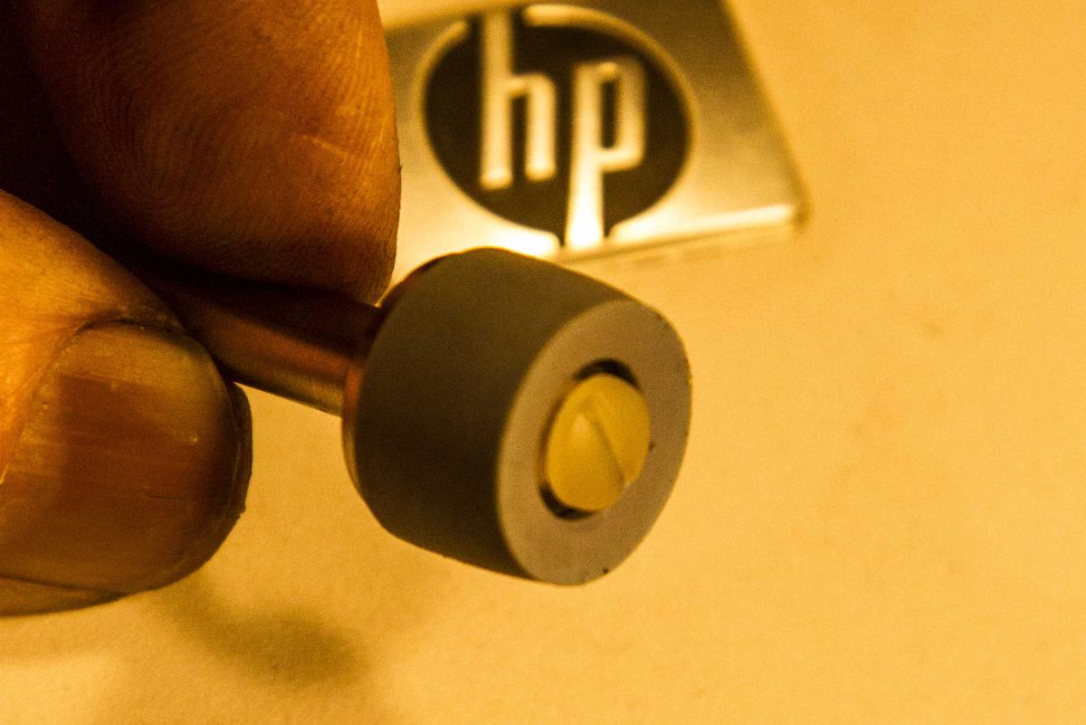

    Because the function knob has to depress the center unlock button, the existing shaft was modified. It was actually easier to modify the shaft, and it can still be used with the 7D camera, just remove the nylon screw. Two plastic spacer washers were removed to give the shaft some in and out range, the shaft was threaded and a nylon screw added, it will depress the button.
    I love a challenge, it is well worth my time to fabricate these parts, as Canon will not sell them, in fact, my design is slightly different than theirs.
    My replacement parts make no modification to the camera housing at all. The only control I am not making access to is the Q button, would be nice, but we can live without it. If Canon would sell the push-buttons, which they will not, it wouldn't be any trouble at all to add the Q button. I could machine a new button but it isn't worth my time.
    I attached photos, sorry, somewhat out of focus, it was difficult holding a flashlight and the camera at the same time.
