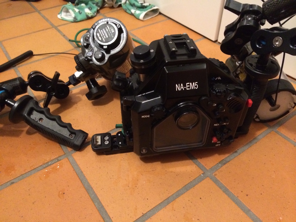

  1. I've always thought the flextray handles seemed a bit too flexy and flimsy. Today's dive proved that true when the left broke of at the start of the dive.
    Forensics show there is only a tiny bit of metal were it broke of, the corrosion hints that it has been underway for a while too.
    So, suggestions on alternative handles that does not mean buying a whole new system would be appreciated :-)
    Cheers/O

    Are there up rated versions for this? Does Nauticam have some sort of replacement program? Or, are there any alternative handles that could it same tray?
  5. I am quite sure Nauticam will replace them. Alternatives are available from say ULCS with much beefier handles. I am a bit surprised at yours breaking, can you see definite corrosion at the break?

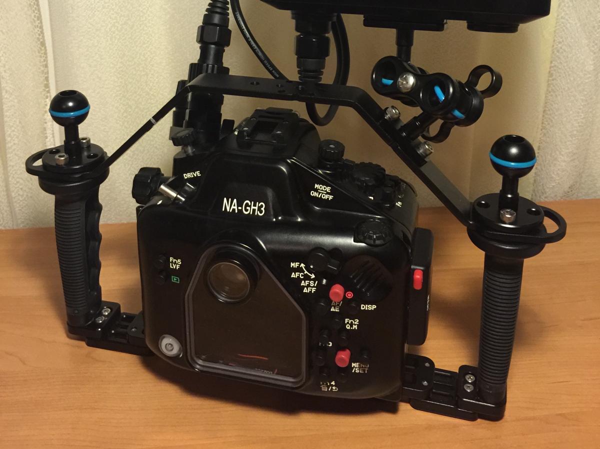

  6. I have a very close call with the Flexitray as well (used on the NA-LX100). Here is what I found out: you MUST use the stainless steel bracket that goes on the top of the handle like this picture:
    During my recent trip, I didn't put the bracket on the right handle and I feel that the handle could be wobble and I don't think the two small screw at the bottom could hold, so I didn't put any light or arm on the right handle to further stress it. You need to call them up and see if they have the bracket for the NA-EM5 otherwise it will break again.
    I have ULCS arm from my old set up, it's very strong and you won't be able to break it, especially if you have the arm with 3/8" bolt.

    I've sent you a PM, but it would be good to get a bit more info on the age of this system. There was a known issue that caused something like this with some early handles. It was corrected, dealer stock was replaced in those cases. If this is that problem, it looks like yours was missed.
    It is normal for the handles to have a bit of flex in them, which some people don't enjoy, and is amplified with heavy strobes or video lights. The handle bracket has been added as an optional install to knock that out.
    Moses, I wouldn't worry about the strengths of those the handle bolt attachment. They brackets are optional, and something like 20 models used this tray prior to their being added.
    Handle brackets were never offered for E-M5. The mounting holes you see on the right grip are for an accessory hand strap, not a bracket. I'm confident that once you get a current handle this won't happen again.

  15. You get brackets with the housing to go on the Flextray handles.
