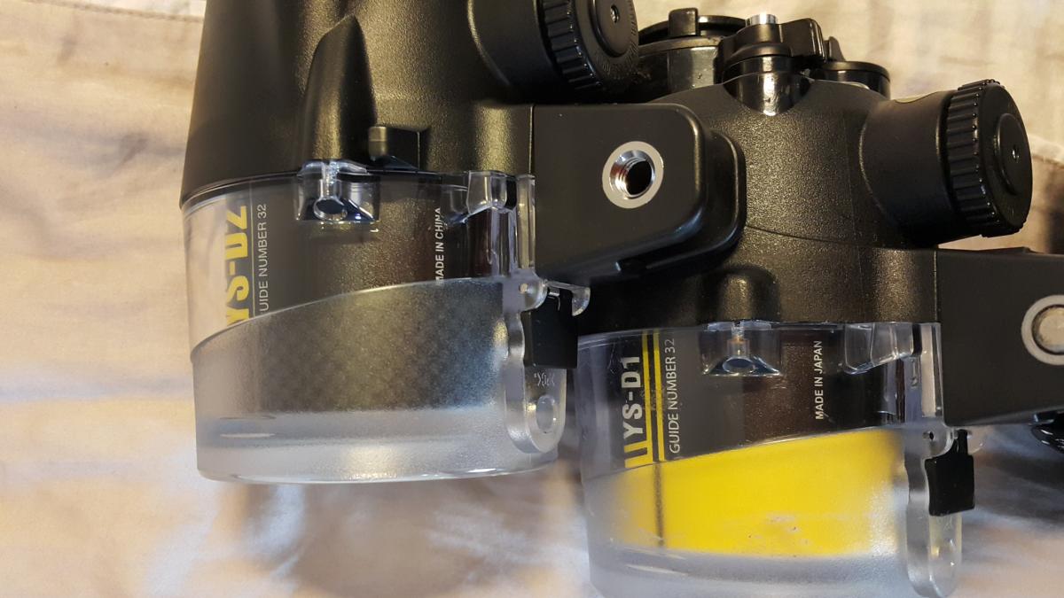

  10. D1 made in Japan while the new D2 made in China.
    Frankly I am surprised Sea&Sea has taken this stance and shifted their production to China. When I did my research, there was no indication at all on the Country of Origin for D2.
