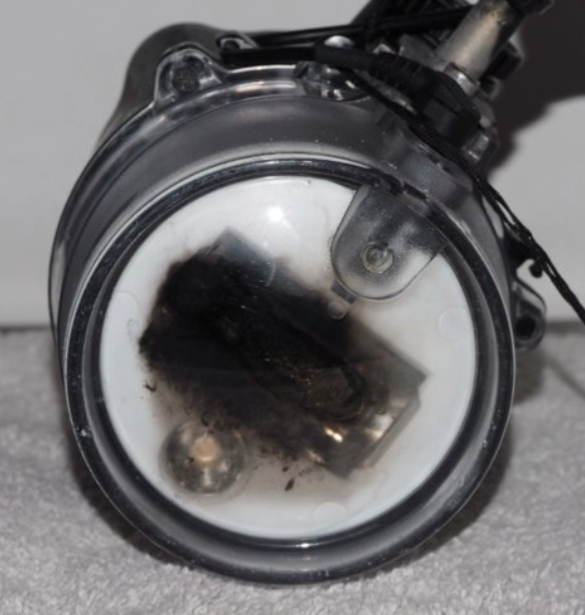

    I recently had a very similar problem with both of my D1's in Truk in June. Both flash tubes exploded on my first dive of the trip. I was using envelop pro batteries. My D800 was set to aperture priority with TTL for the strobes. I shot about 20-25 pictures over 15 minutes before the first strobe failed with a clear popping sound. The flash tube shattered internally. The second strobe did this within the next 5 minutes. I have used these strobes on almost 100 dives before this trip, although I usually use all manual exposure. I heard it may be a battery issue but I have been using the same 1.2v 2450 mAh eneloop pro batteries for over a year and 5 previous trips. Bummer,
