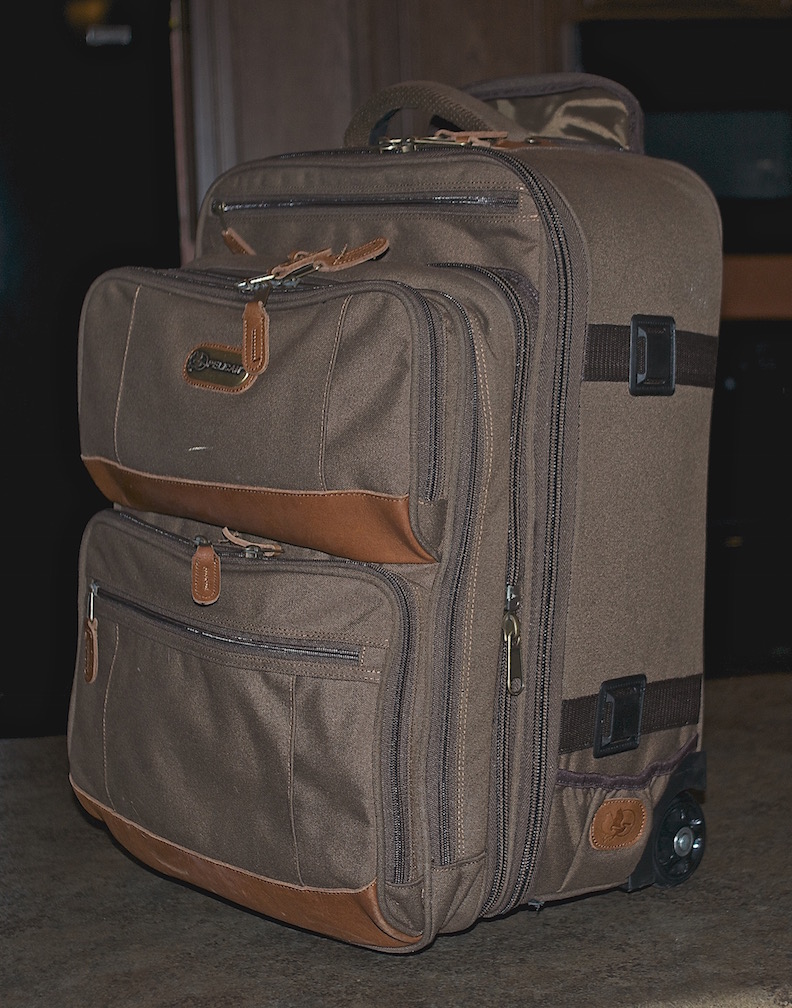

  5. I shoot a Nikon D7100 in an Ikelite housing and I travel with it.
    I'm not a fan of Pelican hard cases. While Pelican cases provide great protection (and yes, I've used 'hard' Pelicans lots in the past for photo assignments), the cases are pretty heavy. I like to keep my camera system in the cabin with me when I do airline travel.
    I do have a Pelican case, but it's not the hard variety. It's a Pelican Gustofson Photo Safari soft camera roller case. I found it in a local camera shop. It was lightly used. My entire D7100/Ikelite housing, three lenses & strobe w. arms system fits in it. This particular case has a zip-off bag that my dome ports (6" & 8") fit in. The zip-off bag also rides in the cabin as a carry-on.
    It's a Pelican!
    -AZTinman
