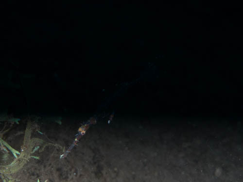

  1. On a recent trip to Indonesia, I experienced what appeared to be a sync problem with my rig. Olympus E-M1 and Sea&Sea YS-D1 strobes. Looking to get a black background, I switched the camera from 1/200th to 1/250th. The result was a half exposed image. Searching the web, I found a thread from July 2014 on Wetpixel discussing the problem (http://wetpixel.com/forums/index.php?showtopic=53721). While a number of alternate setting combinations were discussed, there was no clear comclusion. My own feeling was that I shouldn't have to manipulate a number of settings in order to bump the speed and get a full image. Sure, changing other settings in conjunction might produce a better image. The two images demonstrate the problem. They're not particulary good in many aspects, but were shot of the same subject, the same distance, etc.. The only difference being one at 1/200th, the other at 1/250th.
    I sent a query to Sea&Sea describing the situation. Their response is pretty clear:
    Hello Bob,
    The SEA&SEA YS-D1 is designed to work with flash sync speeds up to 1/200. The strobes are not equipped for “high speed sync”, sync speeds greater than 1/200 sec. The strobe timing will not pair higher than 1/200th of a second, leaving a portion of the image dark. There is no update at this time if SEA&SEA will produce strobes capable of high speed sync.
    Thank you for your inquiry,
    Sea&Sea USA

  15. Hi Bob,
    I tested YS-D1 at 1/250 and 1/320 on several cameras in TTL, - no problem. I tested it also at 1/500 in TTL (Nikon D50 + #11031 TTL-Converter),
    - YS-D1 works perfect even at 1/500.
    YS-D1 works fine at all "normal" sync speeds of camera (without FP), because underwater strobes cannot work in FP mode (FP = 40 khz long time flicker). Underwater strobe can make only a single short pulse.
    This is actual for all underwater strobes.
    Dark part on your image, - is a shutter curtain. Camera mechanical shutter has concrete speed for fully open window, only at this speed the underwater strobe can light the full shot. For modern cameras it is about 1/200 sec. For sync speeds faster than 1/200, the window is not fully open but just as open strip, and we need FP flicker to light the shot evenly when that open strip moves through the shot.
    This is in short words. If you evaluate term "sync speed" deeper, everything will become clear for you.
    According the Olympus E-M1 User's Manual (page 110), your camera maximum normal sync speed is 1/125. In reality it can be some better, even up to 1/200.
    The maximum sync speed 1/320 in User's Manual is pointed to original flash FL-LM2 only. I suppose, this flash FL-LM2 can work in FP 40khz flicker at such fast sync speeds. I guess that 1/320 is FP sync speed there. Unfortunately i don't have E-M1 camera on hands to check.
    What happens in your case:
    At 1/250 sync speed your FL-LM2 burns (flickers 40khz FP), triggers YS-D1 by optical cable, YS-D1 emits a single light pulse (it is more visible in TTL), and you see the shutter curtain on the shot. This is because camera does not open full window at 1/250, but open just a strip. At 1/320 camera opens that strip more narrow, you see it as well.
    But if you use sync speeds less than 1/200 (better use 1/125), camera fully opens the shutter window, the shot is lighted evenly by underwater strobe.
