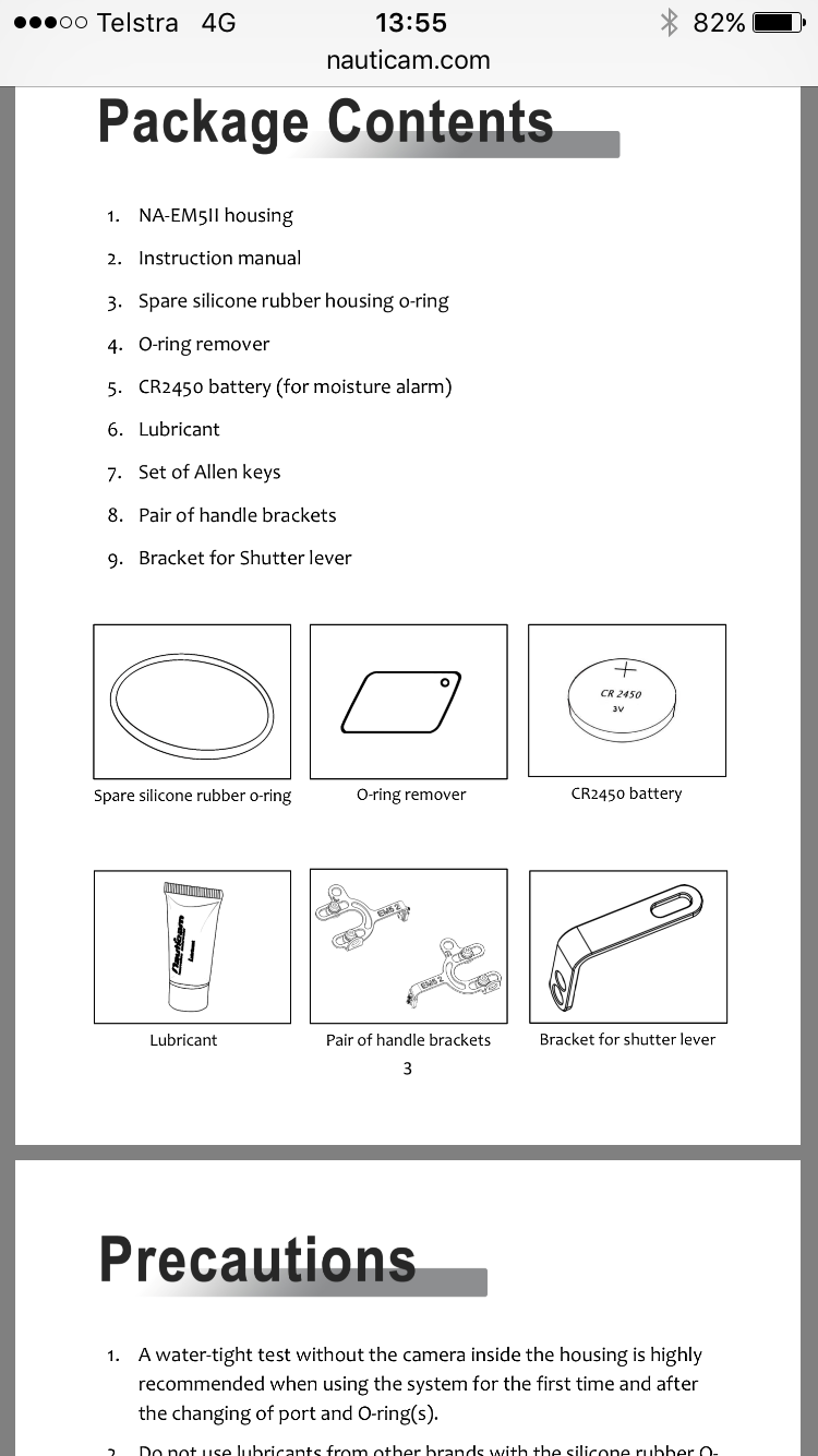

    ps: are those brackets for the flextray inside the housing package wherever u buy it? or if its not listed in package details, better ask the dealer for it?

  7. This is the instruction page from the EM5 MK 2 housing which shows included brackets post-50926-0-44554700-1447398696_thumb.pngpost-50926-0-44554700-1447398696_thumb.png
  8. Thanks. already got reply buy my shop, that it is included! what do you guys think of this shutter extender? an useful?
    the FlipDiopter is from the austrian shop 3D printed I think same as the zoom gear.
