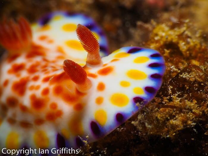

  3. Small Collingwoods Chromodis nudi only 20-25 long, head is about 4-5mm across.
    Olympus EM1 with 60mm macro in Nauticam housing and Nauticam CMC-1. Single S&S YS-D1 strobe
    1/320, f20 ISO 200, strobe less than 1/10 power directly over end of CMC.
    Well worth the effort to master this combination. This was first dive with CMC after selling my Subsee +10 to buy this.

  7. Small Collingwoods Chromodis nudi . . .
    Stunning shot! You must be chuffed to get that on the first outing.
    I'd be curious to know what your max magnification ratio and closest focus distance is with that combination?
    I would have really liked to test the CMC but it's not available where I am, and I was not willing to take the leap of faith required to buy and ship one without testing.
  8. The cmc is 2.0x magnification. The subsee +5 is 1.6x. The former has a really short working distance.
  9. Stunning shot! You must be chuffed to get that on the first outing.
    Thanks, nudi head is 4-5mm across and fills half the frame so is about right for 2:1 magnification as quoted by Nauticam. I agree you need a good focus light to stop hunting but even with close focus distance I managed to get the single strobe to light the subject ok. Last week I used the CMC on my Canon DSLR and Canon 60mm macro lens and the focusing was quicker that being you could focus with the CMC on without having to pre focus first.

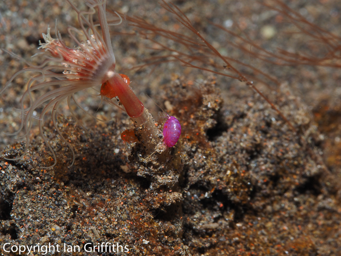

  16. post-50926-0-21364400-1438771469_thumb.jpgpost-50926-0-99252000-1438771537_thumb.jpg
    I took these with an EM1 with 60mm macro with a Subsee +10 which only gives 30% increase of magnification due to its size. I wish I had my CMC at the time as they are so small less than 1mm. The second pic is full frame closest focus with the +10, ISO200, 1/320, f20 and single YS-D1 strobe on about 1/10th power and the first close cropping.

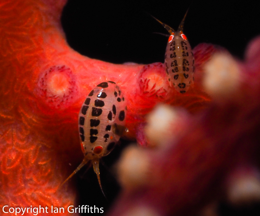

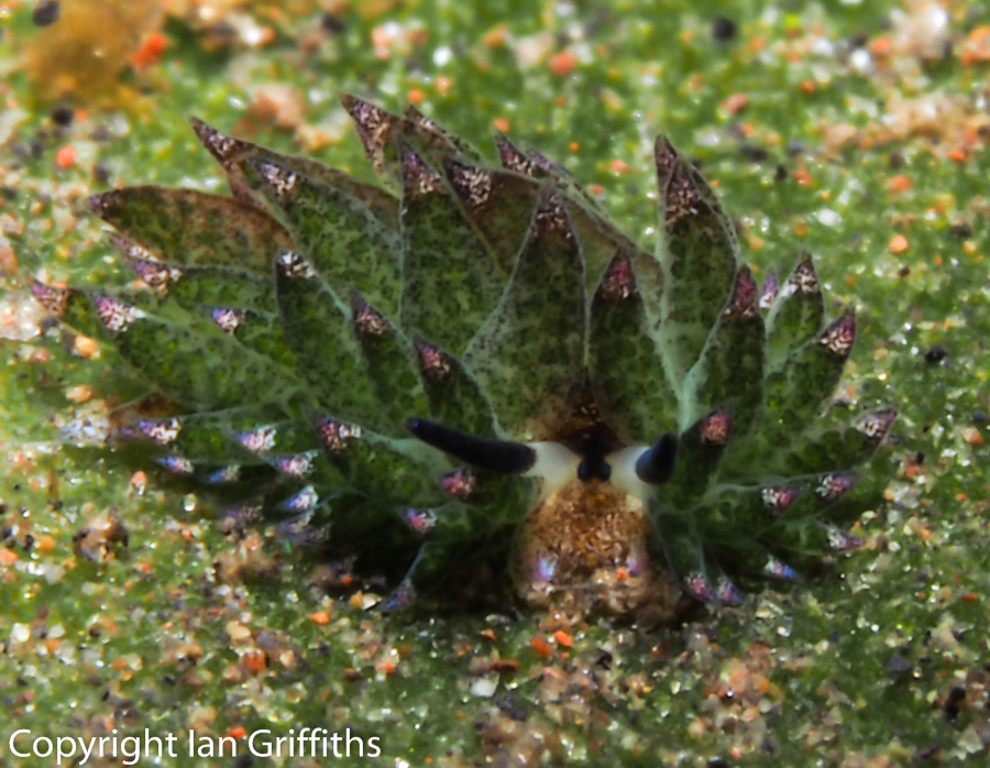

  17. post-50926-0-20080000-1438772308_thumb.jpgpost-50926-0-75434400-1438772340_thumb.jpg
    More subjects where macro is not enough and even a +10 is not enough.
    Amphipods are 1-1.5mm and "Shaun The Sheep" Sapsucking Slug are only 3-4mm. These would of been better with the CMC.
    Those look really tiny but I wonder how many people out there shoot those type of critters or even have access to them
    The CMC looks like a good lens for compact and interesting for people that don't want a macro lens. It also fits some other specific needs for really tiny stuff but I would not class it as an essential item for either the Olympus 60mm or Panasonic 45mm as majority of others can't even spot those tine critters
    I would still think that the nauticam SMC+multiplier on a Nikon D800 at f/32 would have same magnification and probably better IQ but that's a hell more expensive than a mirrorless so for tiny bugs the CMC is a nice toy
