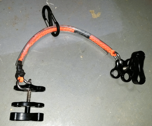

  16. I too braided some bright orange paracord for a carry handle; a small stainless shackle at each end connects it to a fitting that is part of the ball at the top of each handle. I put a piece of clear hose over it to make it more comfortable to carry the rig. Boat crew always reach for the bright orange handle and not one of the arms. Nice. To carry the rig in or out of the water I have a Niteize S-biner on a shoulder D-ring, and clip the bright orange handle into it. I use a separate coiled Cetacea tether from the tray to my BCD while diving.

  19. Can you post some photos of your setup?
    Here is the braided handle. The S-biner is on the strap. The clamps have a built-in shackle point.; they go between the balls on the arms and the first arm segment. The handle is about 14 inches (35 cm) long. The black on the braid is shrink wrap.
