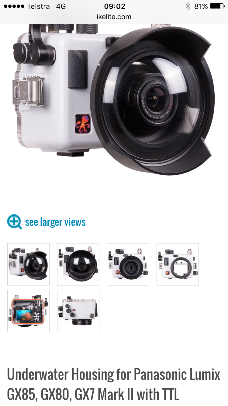

  13. Ikelite are first with an underwater housing which has fibre optic ports too.
