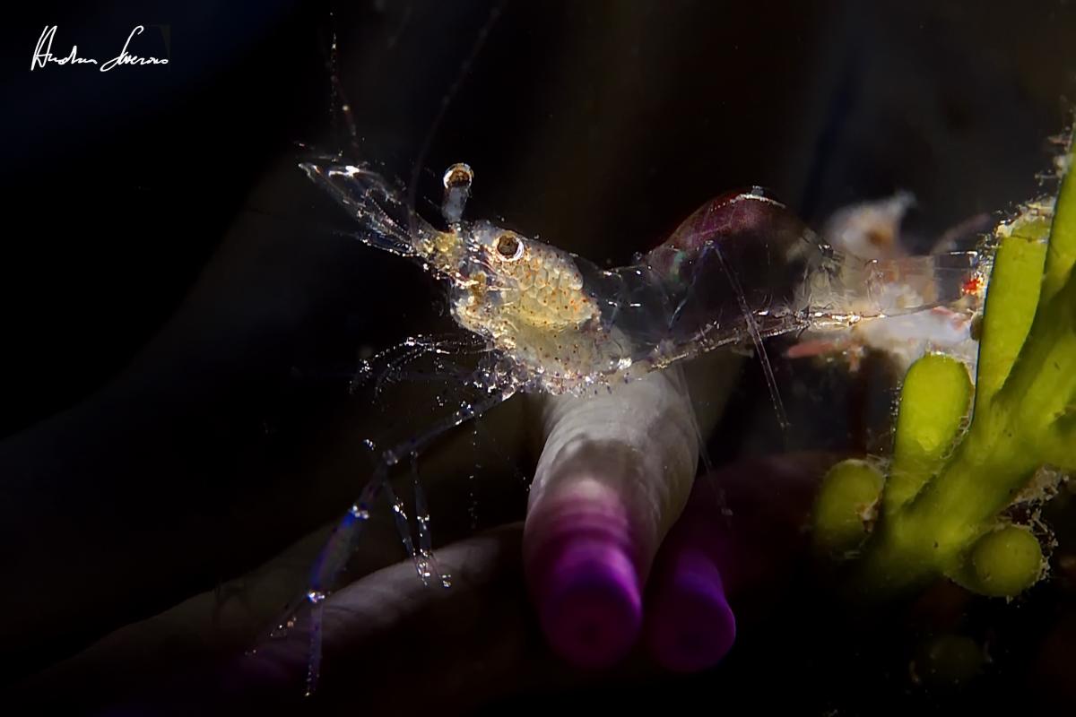

    I am not sure what lights you have tried but I would not be so critical for macro. As an example here I used a 1000 lumen light to get this 1cm shrimp (quite too transparent for strobo shooting!) with a M43 sensor (em5mk1) and 60mm macro set at f11, 1/250, ISO 200. M43 sensors usually give you a bit more flexibility for macro. Probably ISO 200 on M43 behaves as an 800 ISO on FF. However I get a reasonable DOF at the FF equivalent of F22 and certainly a plenty good shutter speed handheld.
