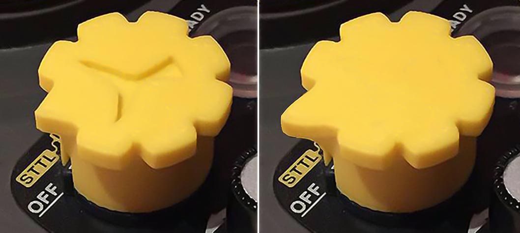

  1. A while ago I downloaded an .stl file from Thingiverse for an Inon strobe knob. I had the knob printed and used it for a few dives in cold water with thick gloves.
    It was absolutely no problem to operate the strobe knobs with this add-on, BUT: The knobs had a tight fitting in the beginning, after 10-15 dives they lost friction, and I lost two of them. Next time I will use some silicone (I am a dentist and have access to low viscosity silicone...) to give them a better friction.
    And there is something else that - IMHO - could be improved: As you can see in the attached picture, the "arrowhead" of the knob is quite small. I wish it was bigger, like in the "Photoshopped" version on the right side of the pic (with a quick glimpse you could see more easily to what position the knobs are set). The file is no longer available on Thingiverse, and I cannot find any contact infos for the uploader, Grega Verč, to ask him for a modification.
    I have absolutely zero experience with 3D modelling or how to modify the .stl-file, Is someone here whom I might bother to ask to do this for me - and others, of course? I attach the .stl-file; hope it is not against any netiquette and there is no copyright trouble (as far as I remember, the file was offered under a CC license, and I used it just for me, strictly non-commercial)?
    To flatten the top of the knob or not is just personal taste.

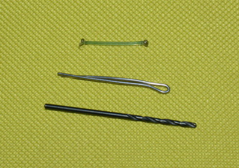

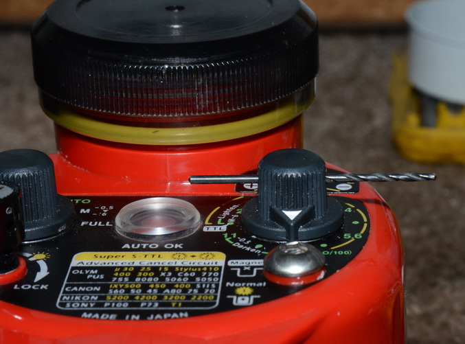

  8. The printed extension knob will fall off sooner or later, unless it is retained with a cross pin. As the Inon knob already has a hollow pin through it, it is easy to drill a 1.5 mm (1/16 in.) hole through the Inon knob and printed extension
    and retain it with a stainless pin or a thick nylon fishing line, as shown here.
    I used a Crest toothpaste cap, it does the job and is free.

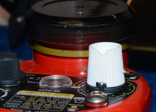

  9. Here you go
    https://www.thingiverse.com/thing:3317377
    you might need to play with the scale to get the fit that you want. mine seems to work at 98% you can vary that in the slicer that you use.
    I don't think it is all that easy , if indeed, possible, to modify an stl file.
    Let me know how you get on
    Trevor
    Edited by Chopcat
  10. Just tested some at 96% on Cura slicer and they fit very nicely.
