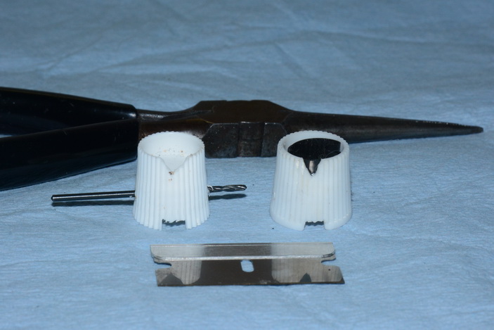

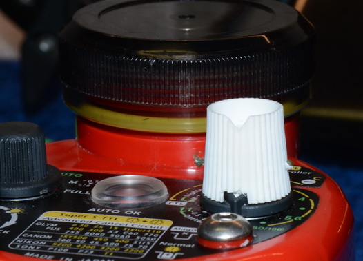

    The two Inon control knobs are identical in shape, but only the intensity Control knob needs an extension for easy operation. A no-cost knob extension can made from a Crest toothpaste cap, as it fits tightly on the Inon's flash intensity knob. A notch in the cap lets one feel the knob's intensity setting.
    Procedure:
    1. With a sharp razor cut a triangular notch in the cap's top, and aligned vertically with it, cut a square notch in the cap's bottom to fit the knob's arrow pointer (Fig 1).
    Fig 1

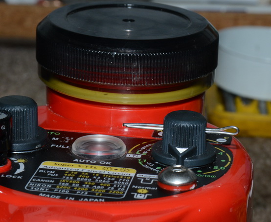

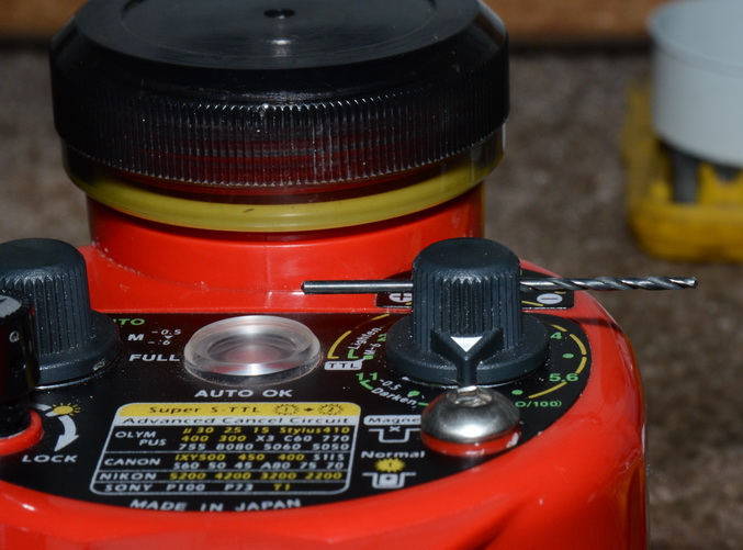

    2. Secure the cap: The Inon knob is kept in place by a hollow pin across its middle; a 1.5 mm (or 1/16th in.) drill bit fits through this hollow pin (Fig 2).
    Fig 2
    Mark the cap 5.5 mm from its bottom edge and 1/4 of the way (90°) around it from the knob's pointer. Fit the Crest cap tightly on the Inon knob and drill 1.5 mm connecting holes through the cap and the hollow pin.

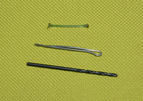

    3. Pass a short length of stainless wire through these cap holes and bend its free ends flat into the cap. For thin stainless wire, first bend it into a hairpin loop (Fig 3 & 4).
    Fig 3
    Fig 4
    Or pass a length of 1 to 1.5 mm nylon fishing line through the drilled hole, heat one end with a match, and while soft, press it into a button; cut the other end about 2 to 3 mm from the cap and also heat it and press it into a button (Figs 3 & 5).
    Fig 5
    Note: A Colgate toothpaste cap can also be used, but it fits loosely on the Inon knob as it is a bit wider (about 2.5 mm) and shorter (about 2 mm). To make it usable, drill out the cap's center with a 12mm (1/2 in) bit, and wrap two layers of plastic electrical tape around the Inon knob, so the cap fits it tightly. Fig 1 shows the Crest cap on the left and the Colgate cap on the right.
