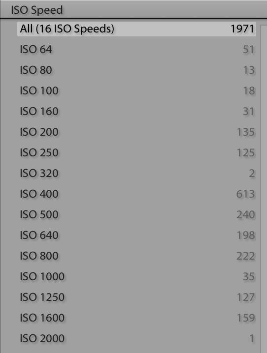

  9. I’ve continued to use both, since the D3 came out. But increasingly I use the FX option (in my case D5) for more and more of my photography.
    I think a major reason in this (apart from the D5 being an amazing camera - if you like the D500, you’ll love the D5, it is even more of the same) is the FX wide angle solutions I am using. Three of which are water contact optics (I use 3 - RS-13mm, Zeiss Ivanoff with 20mm, and Nauticam’s forthcoming lens). These at the very, very least negates any advantage that a DX system has regarding corner sharpness, therefore allowing me to shoot at more open apertures and restoring the ISO advantage of an FX body.
    ISO flexibility is a huge part of how I shoot underwater and FX does this best. This is something that I value even in bright, topical destinations, because it is not bright everywhere! Below are a couple of examples - the first from my first 2000 shots in Cayman Dec 2016 to show the spread of ISO values I used (all set manually, no Auto-ISO):

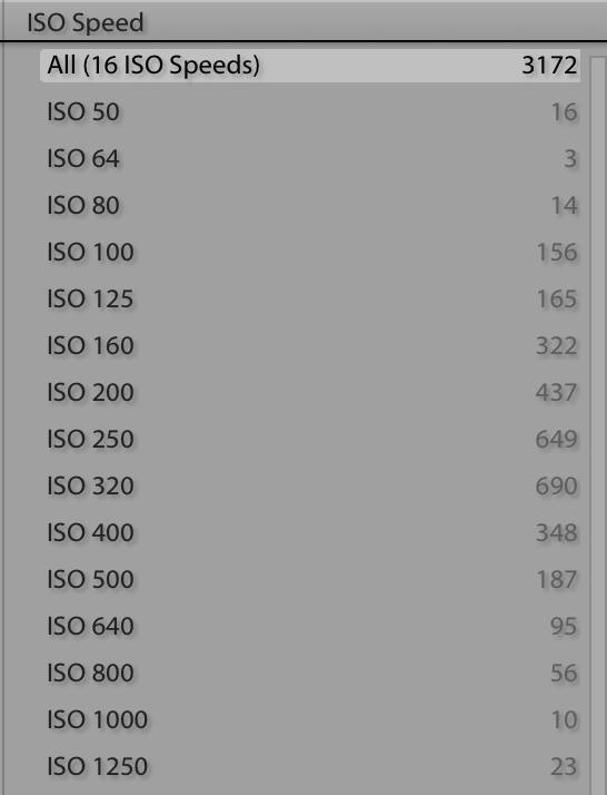

    This example is from the Wetpixel workshop in Lembeh Oct 2016 - also with Nikon D5 (although I think it includes some shots taken with D500 and some with my Olympus):
