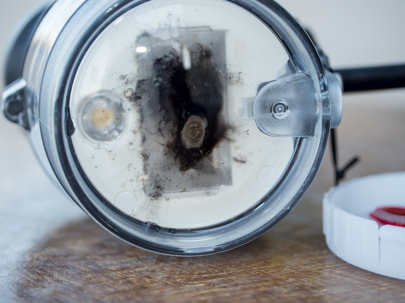

  1. My Sea & Sea YS-D2 flash tube has just broken! The unit is only 15 months old, and has done about 300 dives, when I checked my gear pre-dive today I noticed that one of my two strobes no longer worked. On closer examination I found that the flash tube in one strobe was just a pile of powder inside the housing, is this normal after such a short time?
    I have just switched from mainly macro work using TTL, to wide angle shots where I use manual mode and generally more strobe power, could this have something to do with the problem?

  4. My YS-D2 burst its bulb in during a trip last September, right after the warranty was up. Backscatter did some testing and it turns out something was wrong with the strobe's system where it was dumping full output into the bulb, so a replacing the bulb would just eventually end up bursting again. Backscatter is pushing Sea & Sea to do a replacement because they've had a number of other customers with D2s that have failed right after warranty. Between this and my bad experience with 2 D1s, I'm really disappointed with Sea & Sea right now.
  5. I only can add another problematic YS-D2 case: I bougth two of them few weeks ago and after approx. 30 dives one of them looks as in the foto attached. It still works, but presumably at lower output.
    The only ray of hope is, that my dealer ("Unterwasserkamera" in Vienna) says it is under warranty and I will get it repaired...
    Wolfgang :(

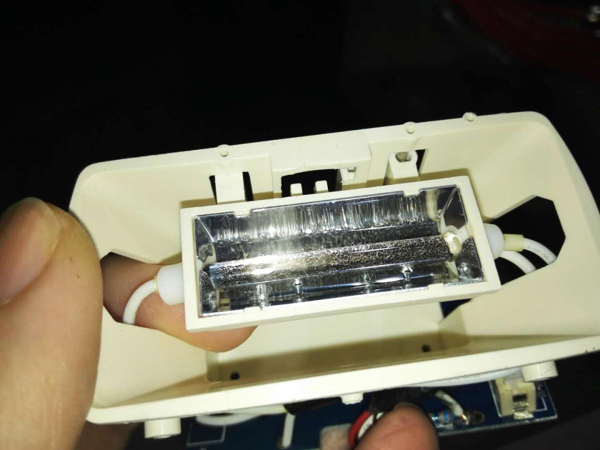

  16. This is caused by poor heat dissipation. this is a land strobe.its Lamp tube surface has chapped and aged.But it never burned,never broken.Because the land flash has a zoom structure, it has a large gap around Lamp tube reflector.But the underwater strobe tube is sealed around.

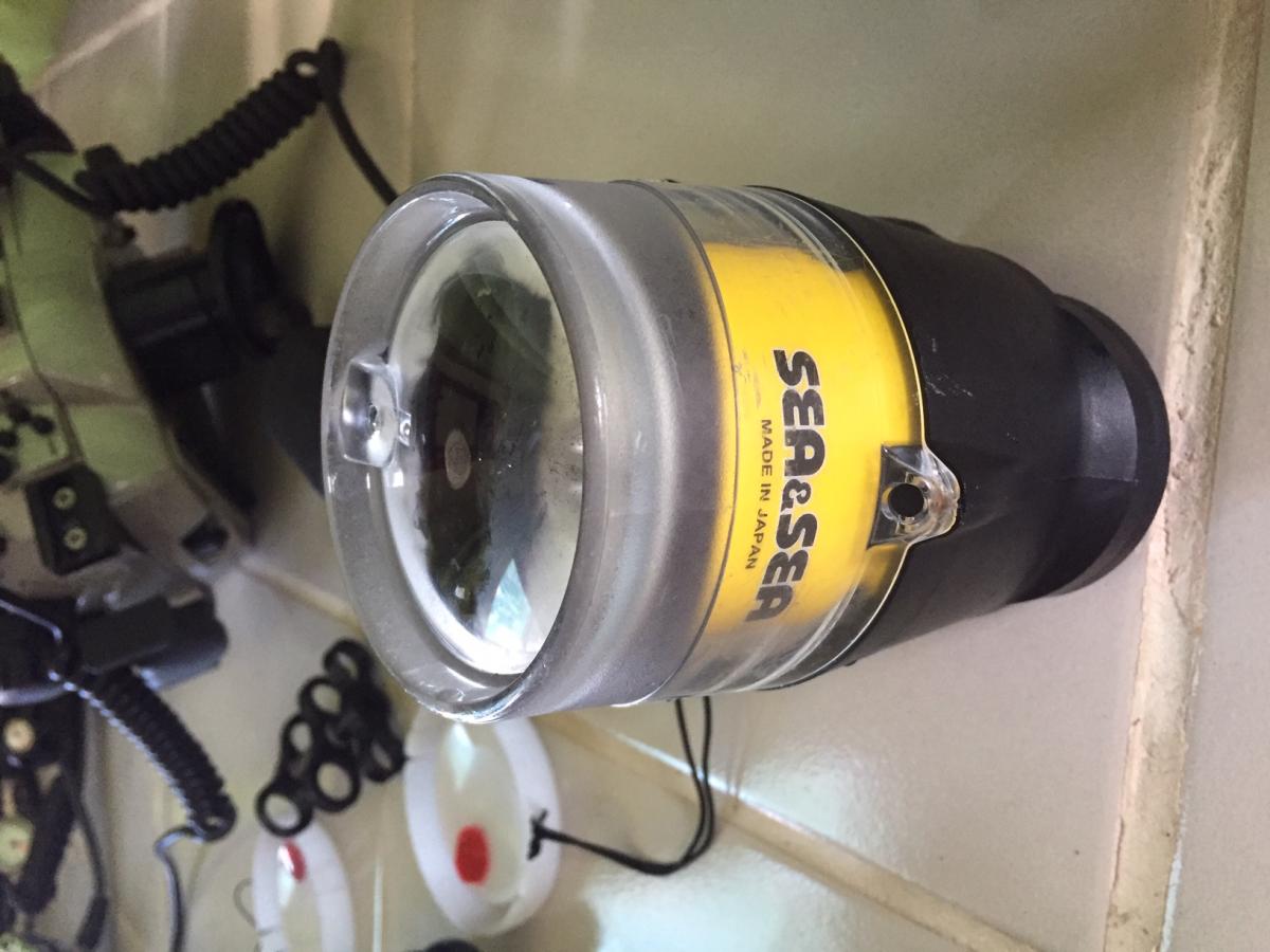

  19. After having a YS-D2 replaced for not turning on, the replacement YS-D2J has now exploded. Yes, the Version manufactured in Japan. The strobe was on at the time but not being fired. Theres absolutely not a drop of water in the battery compartment. Has anyone else had this problem with the new YS-D2Js? Its such a pity as theyre a good strobe to usepost-47470-0-95736300-1556406081_thumb.jpeg
