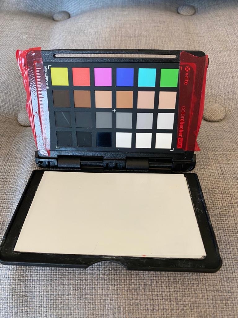

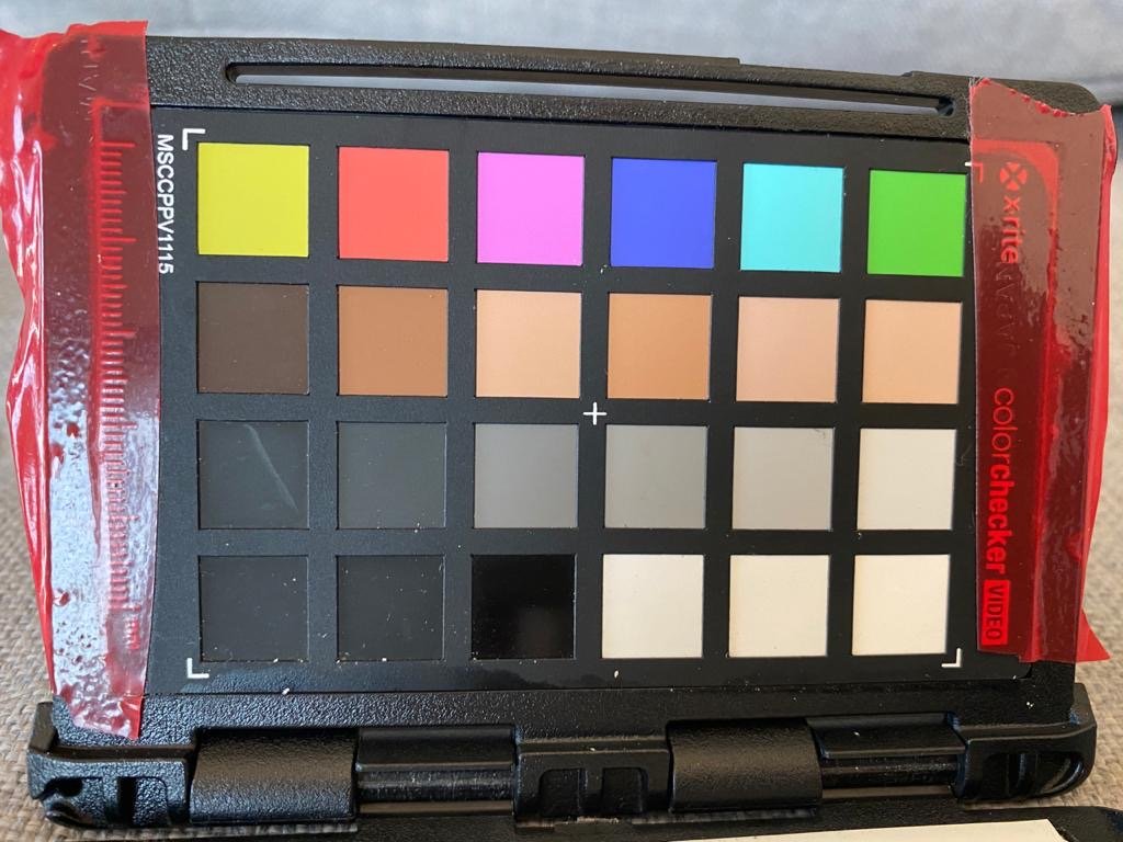

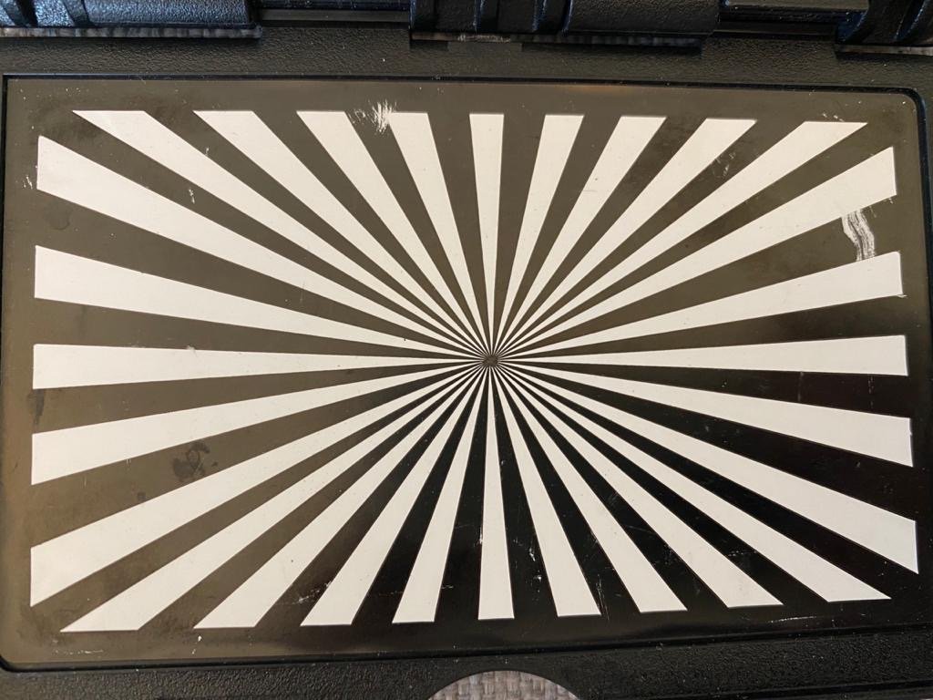

  15. Hi,
    I wanted to update the topic with some images that show the condition of the color checker after 4 years of use. Honestly, I am impressed with the quality of the chart especially with color blocks that are still retaining the original colors. The main problem is that the pages after a lot of use come out cause the glue deteriorates. This can easily be fixed by using super glue.
    If you do underwater videography as a profession or you can afford a color checker, it is worth the investment. Remember to chose a video chart that is supported by your editing/color correction program. The color checker needs good lighting to produce good result. It can get you to a good starting point for color correction or can be used as a good reference.
