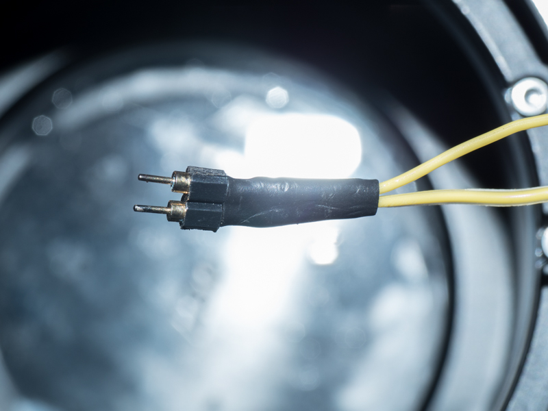

    Finally I could solve the problem, it was as Fofo suspected: the build quality of the leak sensor by Nauticam, which is just two open end wires (a shame they cannot even produce such a sensor in a good way). I again squeezed the two endings apart, this time with more force (and separated the two yellow wires), and all over sudden the system works again (see foto for squeezed sensor)!
    At home I will solder the sensor in a better way, without shortcut possibility, so the problem will not reappear again, but for the remaining time here it will suffice...

  7. Just an update on the Nauticam moisture sensor, in case someone is interested:
    I had the problem fixed by a friend, who is a professional electronic ingineer (just clean soldering of the contacts to the wires).
    The moisture sensor functioned without problems for many shoredivings in Austria and Egypt since September 2017. Recently I undertook a Boat Safari to Daedalus Reef (no other boat divings since September 2017). Already when I assembled the camera in the boat cabin, located in the ship's hold, still in Port Galib, the sensor light turned red again, presumably from high humidity condensing on the metal contacts. Next day, when we were out (and humidity presumably lower), same problem...
    I only could solve the problem by clipping the metal contacts away and leaving the blank wire ending. They also should indicate water in the housing - I think I will leave the moisture detection in this stage now (In addition I have vacuum)...
