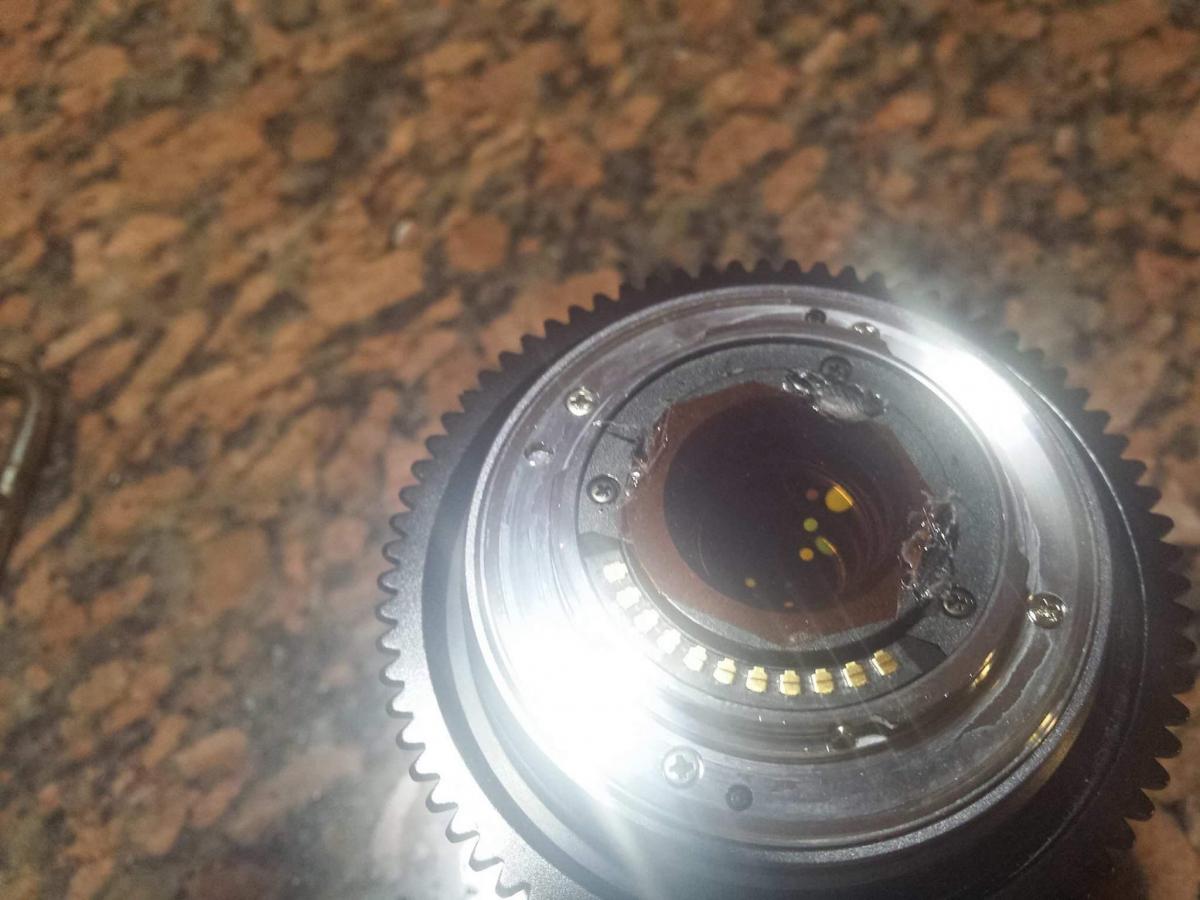

  1. I'd like to attach a magic filter to the rear of my 7-14 lens and have been told to use hot glue by someone who has done it before but I thought double sided tape would make for a lot more flexibility for when u don't have any access to hot glue, as would be the situation on many dive vacations. Has anyone done this before? Any thoughts on the tape? Could take be the wrong move, could it be too thick making the filter touch the sensor?
    All input is much appreciated!
    Attached a file of how it would look with glue.
    Cheers!
  2. I'd like to attach a magic filter to the rear of my 7-14 lens and have been told to use hot glue by someone who has done it before but I thought double sided tape would make for a lot more flexibility for when u don't have any access to hot glue, as would be the situation on many dive vacations. Has anyone done this before? Any thoughts on the tape? Could take be the wrong move, could it be too thick making the filter touch the sensor?
    Cheers!

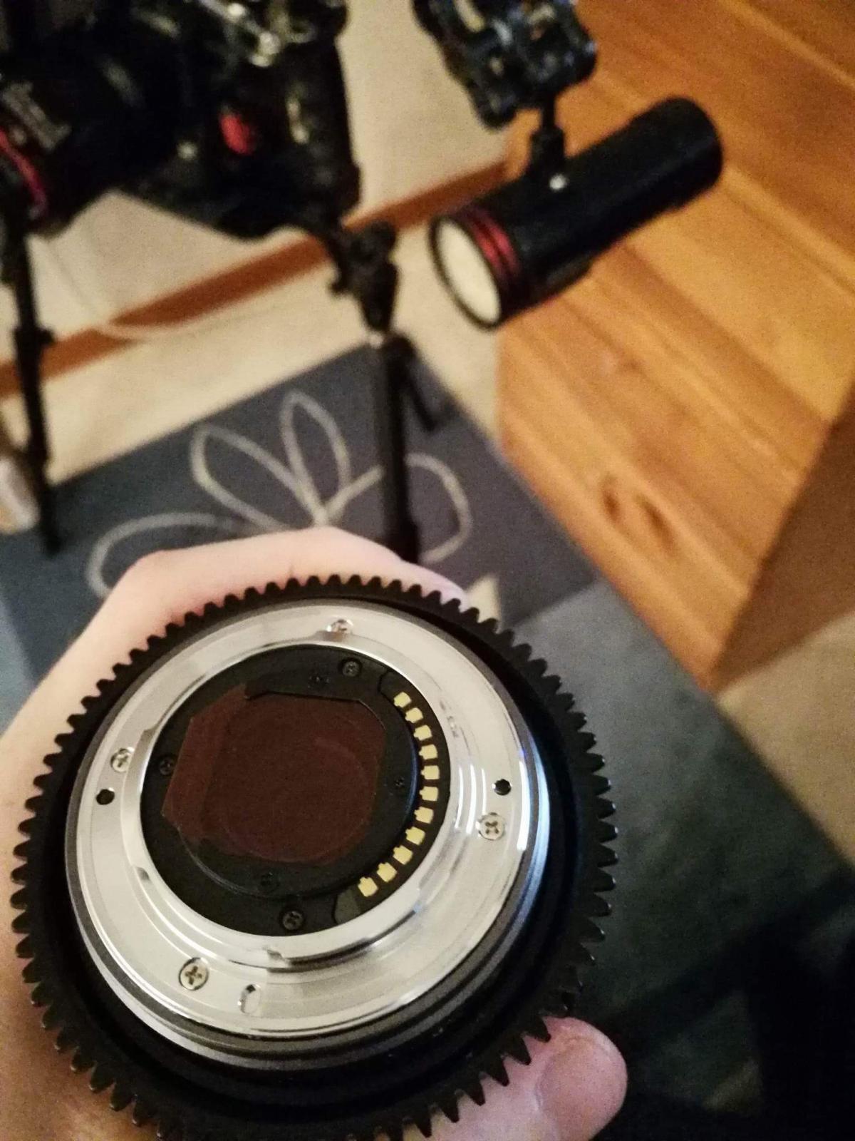

    I used to use tape to attach the filter, then I ended up buying the filter holder made for the 8mm fisheye lens and installed that on the back the lens. I don't see any reason to use glue.
  3. I used to use tape to attach the filter, then I ended up buying the filter holder made for the 8mm fisheye lens and installed that on the back the lens. I don't see any reason to use glue.

  4. Obtaining the filter holder is quite easy. As to fitting its (from memory) just 3 screws to remove the current back plate and fit the 8mm filter holder. Many mention about filing off this and that to get it to fit, but mine just screwed straight on
    Regards - Richard
  5. Obtaining the filter holder is quite easy. As to fitting its (from memory) just 3 screws to remove the current back plate and fit the 8mm filter holder. Many mention about filing off this and that to get it to fit, but mine just screwed straight on
    Regards - Richard

    I just changed out the filter folder the way trickster described. I remember seeing mention of needing an additional plastic spacer/shim - but I did not find that step necessary.
    Here's that thread:
    https://www.dpreview.com/forums/thread/3480692
  7. I just changed out the filter folder the way trickster described. I remember seeing mention of needing an additional plastic spacer/shim - but I did not find that step necessary.
    Here's that thread:https://www.dpreview.com/forums/thread/3480692

    Depending on which country you are in. The part is easily obtained from the nearest Panasonic Repair Center. The DPReview forum above mentions the part number required, of if like me you have the 8mm lens - I just swapped them over.
    Regards - Richard

  15. Thanks to all - this forum is indeed very informative - I just ordered the holder from the dealer Pajpen suggested and will install it on the Panasonic 7-14mm... :drink:
    Does anyone know, whether there is a similar holder existing for the Zuiko 8mm FE?
    Wolfgang
  16. Hi,
    I just got the filterholder (part No.: VXQ1911; was about 30 Euro including postage) and mounted it to my Pana 7-14mm: as the others say - just unscrew 3 screws, remove old part and replace - no additional trickery, very easy...
    Unfortunately I ordered only one from Foto Geissler - seems to me that the part would also fit to the Zuiko 8mm FE: Did anyone test this out?
    => I do not have time now to try out by myself, since I have to pack for 16 days diving vacation in Marsa Alam/Egypt (will leave tonight), maybe I take the screwdriver with me...
    Wolfgang :bye: :bye: :bye:
  17. Today (27.11.) I tryed to mount the filterholder to the Zuiko 8mm FE. Although the holder is very similar to the endogenous plastic part the holder does not match. Maybe the holder can be adjusted, the holes for the three screws seem to match, but no time and tools now...
    Wolfgang
