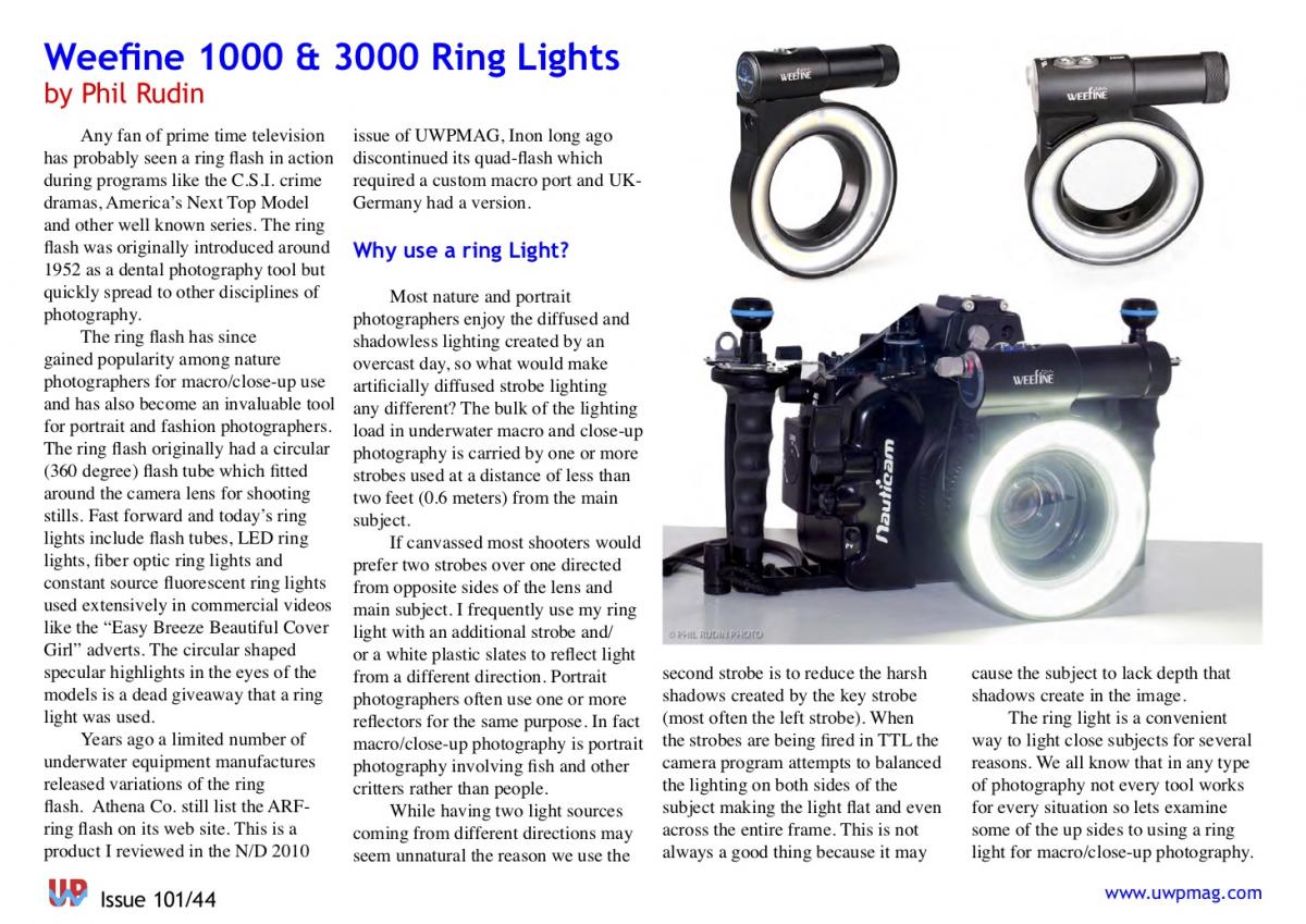

  2. I reviewed both the Kraken (Weefine) 1000 and 3000 ring lights in issue #101 at uwpmag.com. I think that most of the questions ask above are answered in my review of both light. Find the review on the front page of the magazine in the back issues section, it is a Free PDF download.
    Happy to answer any followup questions.
