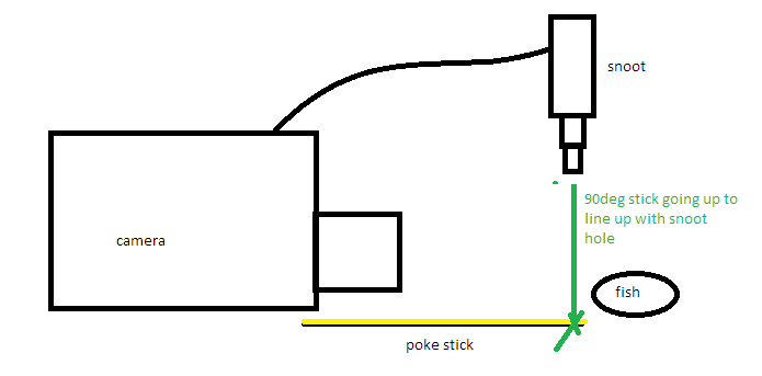

    I had an idea for my current snoot and DSLR setup however, and that was to use a physical guide, as my focus light is crap.
    If you have a poke-stick which you point out from below your DSLR, with another 90 degree stick going straight up, in to the snoot hole (or wherever the light comes out from), then you know that if you set the snoot there, and you're always at that distance, you're in the ballpark. I may try this out at home with some chopsticks and bluetack...

    My understanding is that part of the problem is that although snoots in general try to funnel or even shape light, it does come out somewhat off centre with regards to the position of the focus light on most strobes (z330 may be a slight exception).
    Interesting, I’d not heard this before. Any thoughts, Oskar?
  12. We have experimented with markers and focus sticks but found it's faster and less cumbersome to make use of the technique described here: http://wetpixel.com/forums/index.php?showtopic=62595&hl=
    You can always mount a stick with a rubber band to your snoot and mark the focus point. Maybe it can work for you.
    The YS-D1 has a relatively weak pilot light, not only for snooting, which is why they powered it up with the YS-D2.
