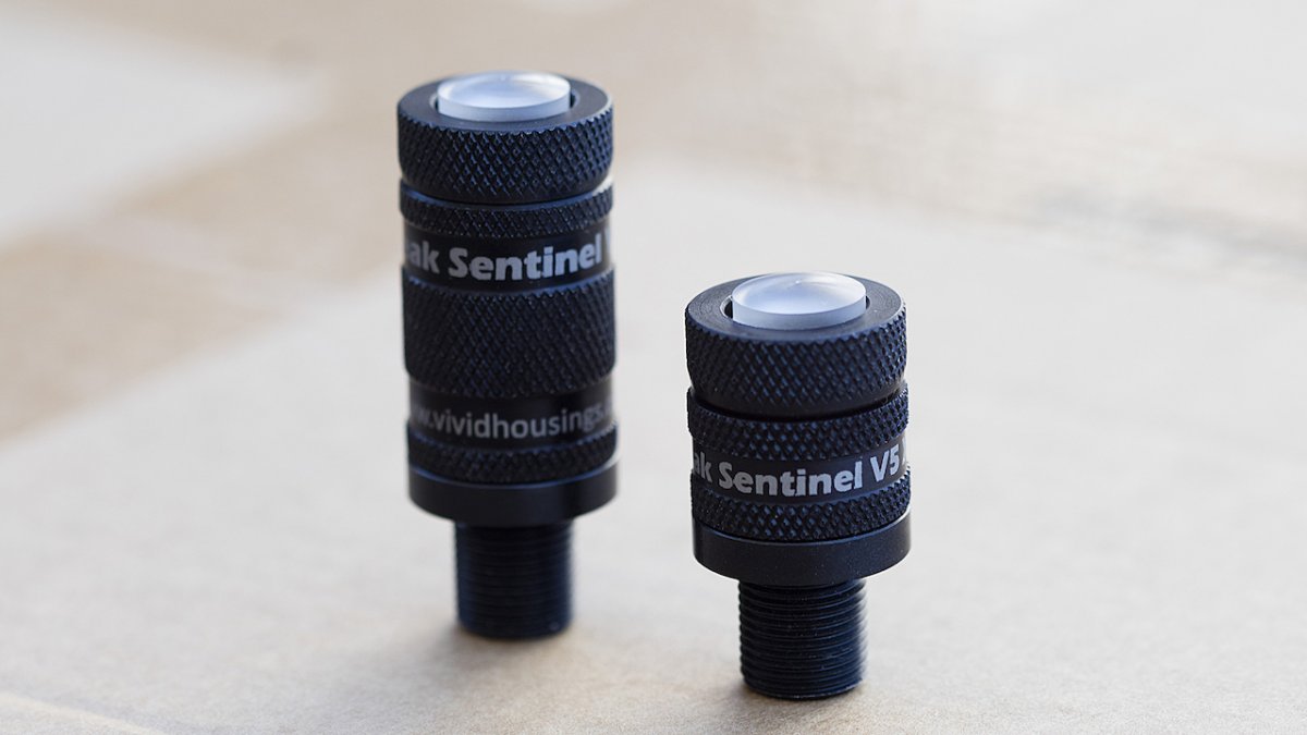

    My V5 is on its way. I'll do a couple of pics of the V3/4 and V5 to compare them once it arrives.

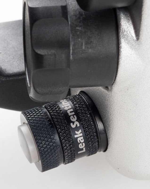

  4. it looks higher then the V4. While the V5 look like the LED is better seen from above, I wonder how well you see it from the side. I'll stick to the V4 :-). Which I wont hesitate to recommend...

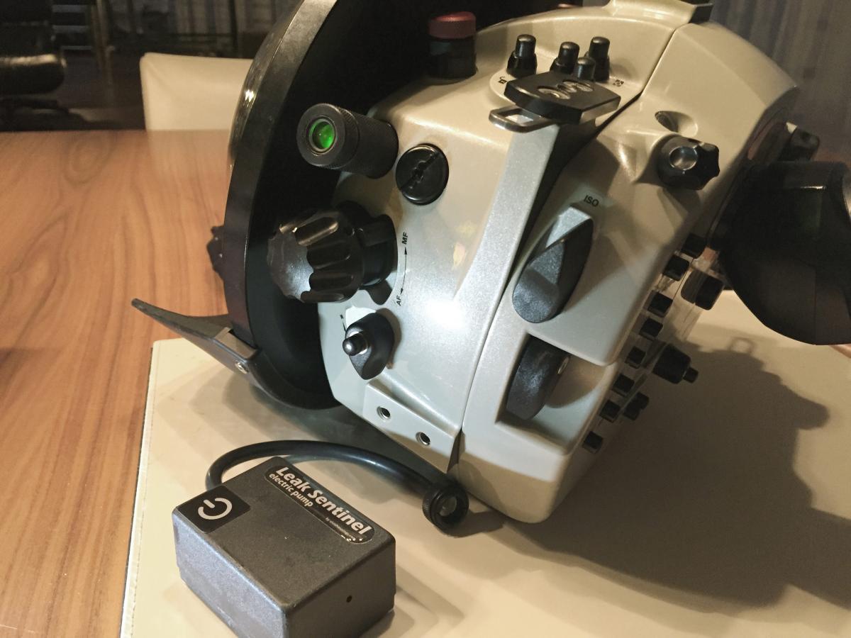

  5. My V5 arrived this morning. That's 5 days to get from Vivid in Slovenia to Amsterdam. Pretty good I thought.
    The V5 comes packed in a foam-fitted cardboard box with spare o-rings and batteries. The electric pump (I said I'd give one a go) is very neat indeed (7x5x5 cms approx) and comes with a 9v battery fitted. The hand pump (my preference) is handily smaller than the V3/v4 although the fittings are the same size. The adaptor that screws into the valve has a transparent area so that you can see the flashing LED.
    Here's a couple of pics to show the relative size with the V3/V4. As I said above, I went for the V5 "Special" where the electronics are inside the housing. The box contains transparent sticky pads to attach the electronics onto an inner wall of the housing.

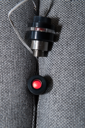

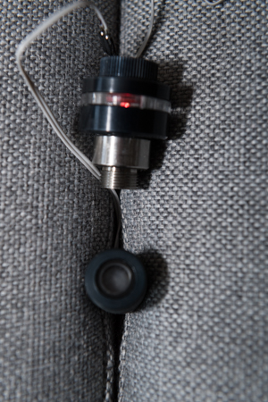

    I also took a couple of pics to try and show the relative size and intensity of the LED. I couldn't manage to get a pic with both flashing at the same time! As Cerianthus points out, the LED might be best seen from above with the V5. I can't really say yet. But I always struggled to get the V3/V4 LED angled in such a way that was easily visible when holding the housing in the usual photographing position.
    But so far, a very neat package and looks good.

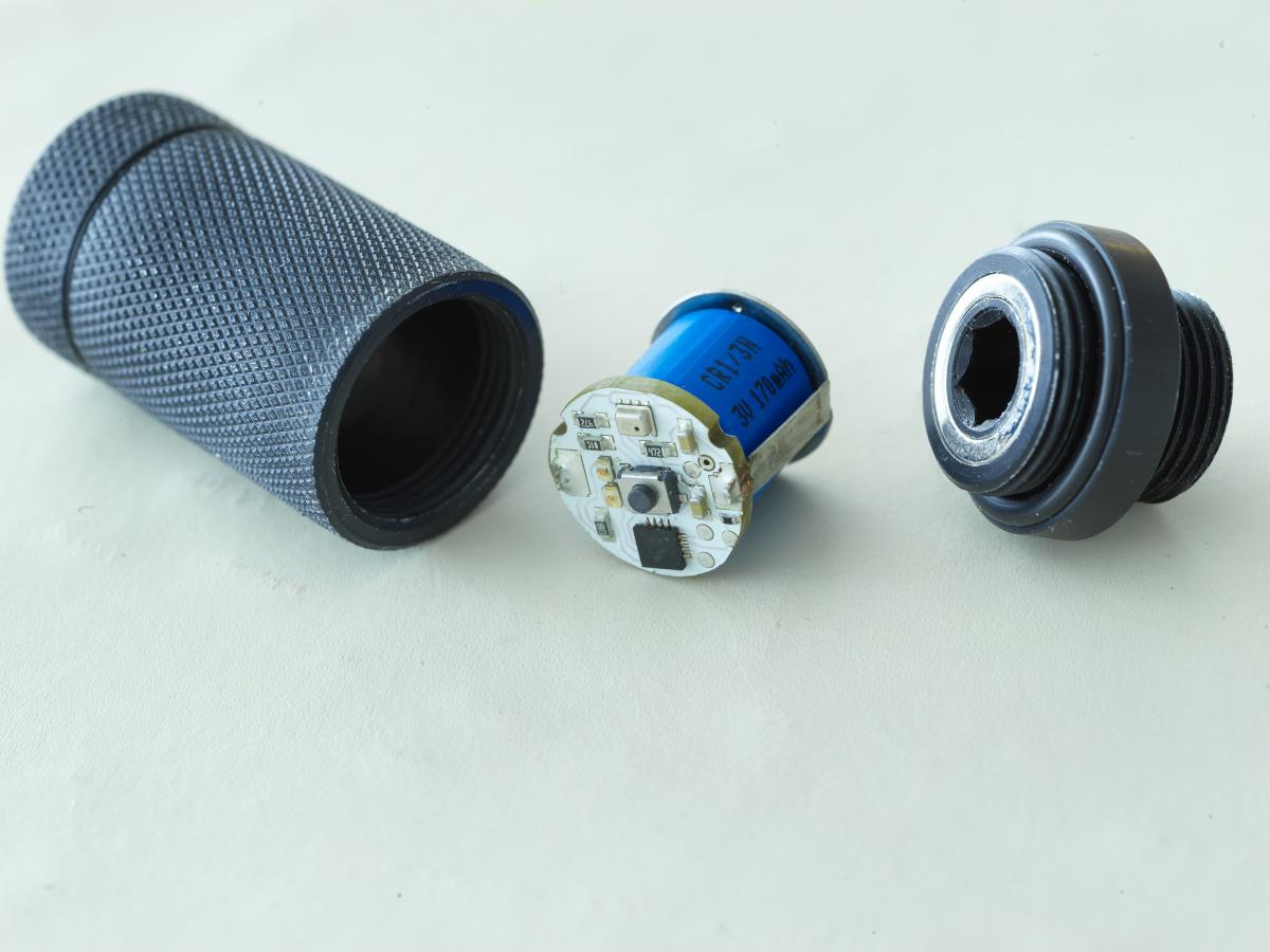

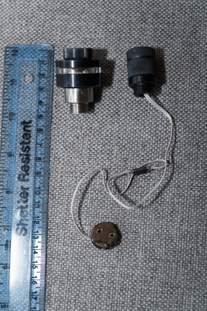

  6. this is the V5 which is specifically made for housings like Subal's with 2 ports nearby, one to use for the Sentinel the other for e.g. a HDMI connector/cable or in my case for a 'manual flash output turning knob'. After some first hand problems works now very well. Just waiting on the new Subal ND850 now.
    In front is the electronic vacuum pump (powered by an integrated 9 volt standard battery).
    Sorry for the low quality of the pic (shot on iPhone for ease and quick...)
  7. forgot to mention above: electronics PCB and small battery is inside the valve, outside of the housing

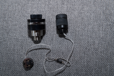

  8. Juerg, any chance you could post a pic of how/where you fitted the PCB and battery inside the housing?
  9. here you go. The middle part is the sucker of the PCB with the blue little battery underneath. Left is the valve housing, right is the final part if the valve which is screwed into the housing port (M14 as for Subal). Pretty neat isn't it?

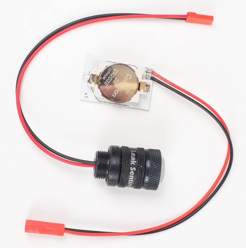

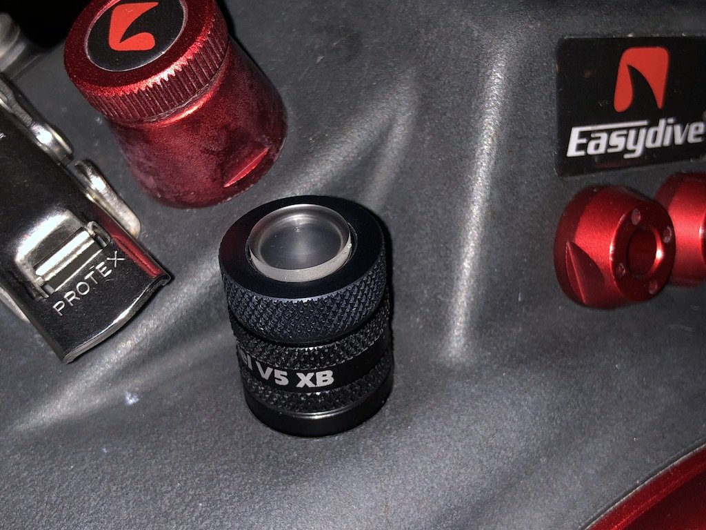

    The two parts of the V5 XB: the main body, and the battery board
    Pictures of the V5 XB installed:
    LeakSent-4_b2b9-di.thumb.jpg.d4b5abec1aa03cc2d8ed30dc659a0a5d.jpgLS-Install-8_lj10-uk.jpg.9240b9add06f930d5cbc42673c17f9d1.jpg

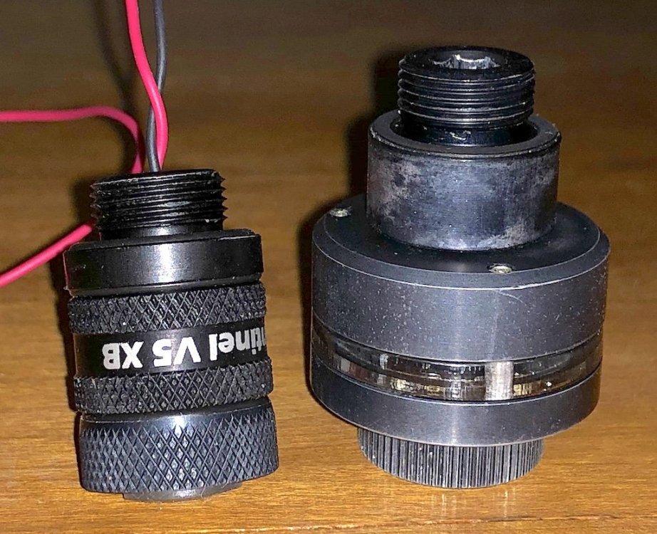

    Here is the comparison between V5 and V5 XB:1447700453_Comparison_XB_STANDARD.thumb.jpg.5ac0ae6d5d010552d15abd92eda1446f.jpg

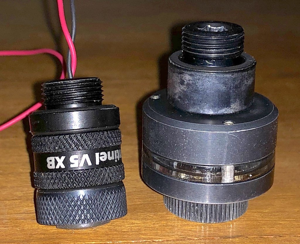

    The reduction in size is even more spectacular when comparing to the V4:

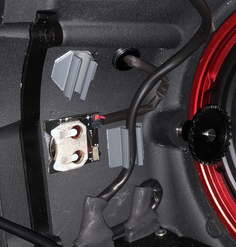

    The installation was quite straightforward: unscrew the V4 from the housing, screw the V5 XB, cut the wires to the appropriate length inside the housing, connect the wires to the battery PCB.
    The inside of the housing is quite roomy, so there was no shortage of space to place the battery PCB:

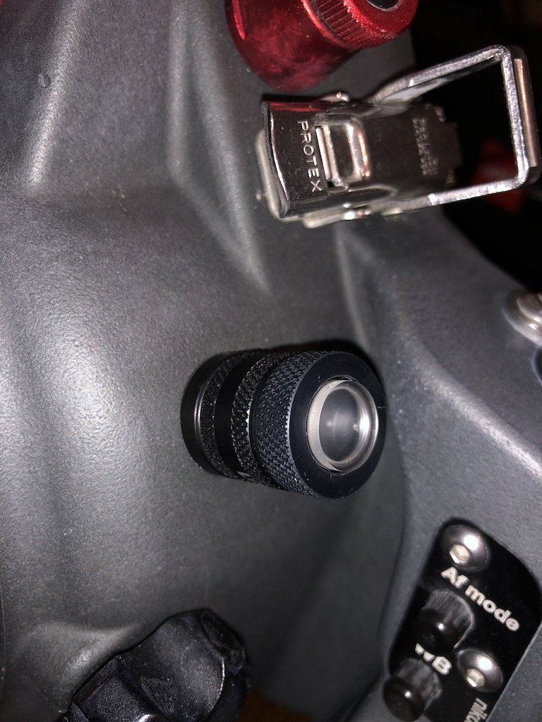

    There was a massive leak, and the housing could hold vacuum! :o

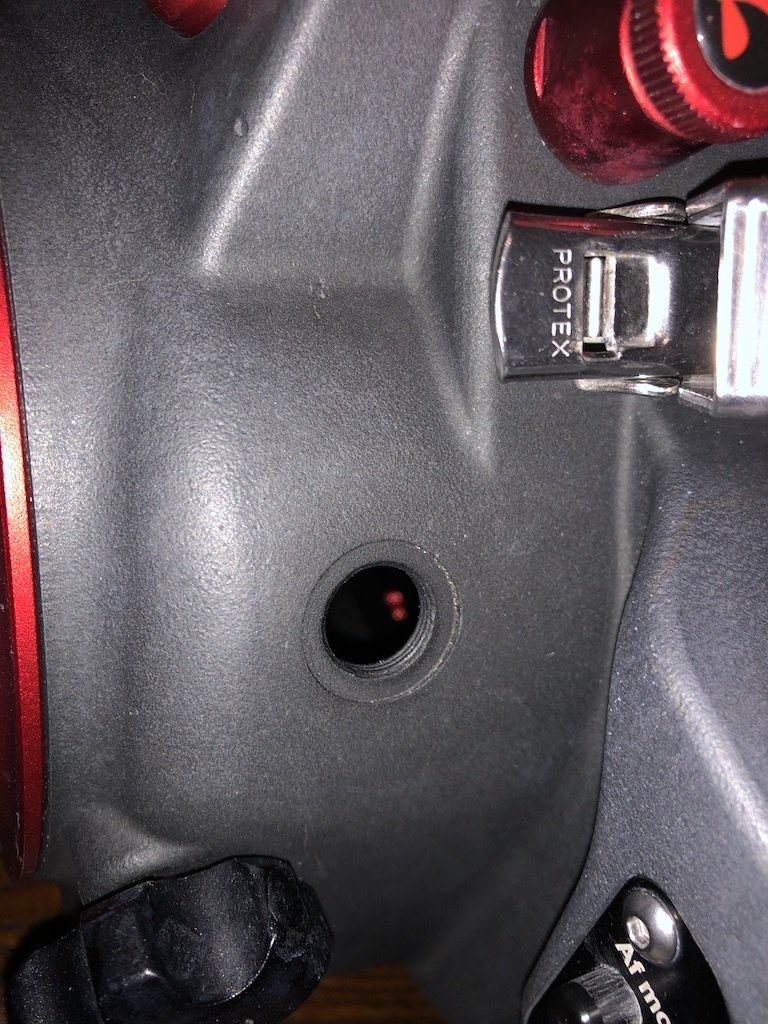

    After looking the source of the leak, I found that it came from the seal between the housing and the Leak Sentinel. The base of the V5 XB is slightly wider than the V4 (barely noticeable, about 0.1 mm). The connector on the housing is surrounded by a groove which fitted well with the V4, but was too tight for the V5, and it was preventing it to fully screw and make a thigh seal.
    Fortunately, the housing has a second connector on the right hand side which was not previously used. The V4 was too big to be placed there, but the reduced size of the V5 meant that it could fit there.
    There was no further issue with this second connector, and the seal hold tight!

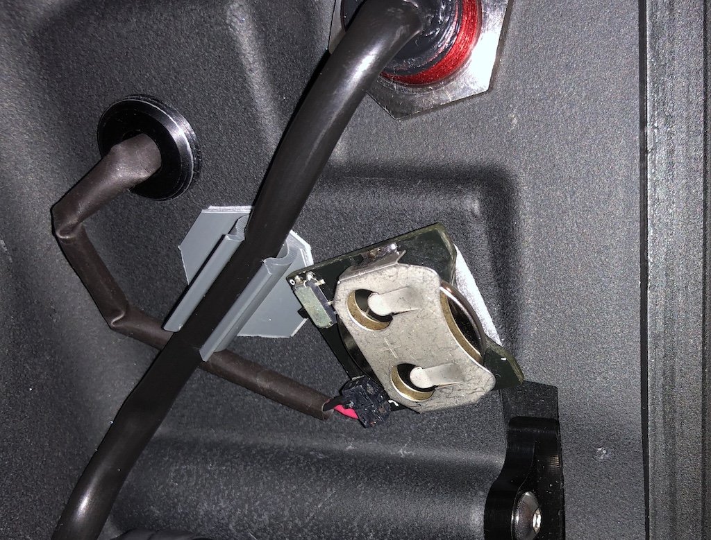

  16. The only drawback of this new position of the V5 XB is that the inside of the housing is a bit more crowded on this side.
    IMG_4067s.thumb.jpg.a99fcb94bd773a9307aa266b99e2193a.jpgIMG_4069s.thumb.jpg.7c413e5b6392a869aca0eb902773907d.jpg

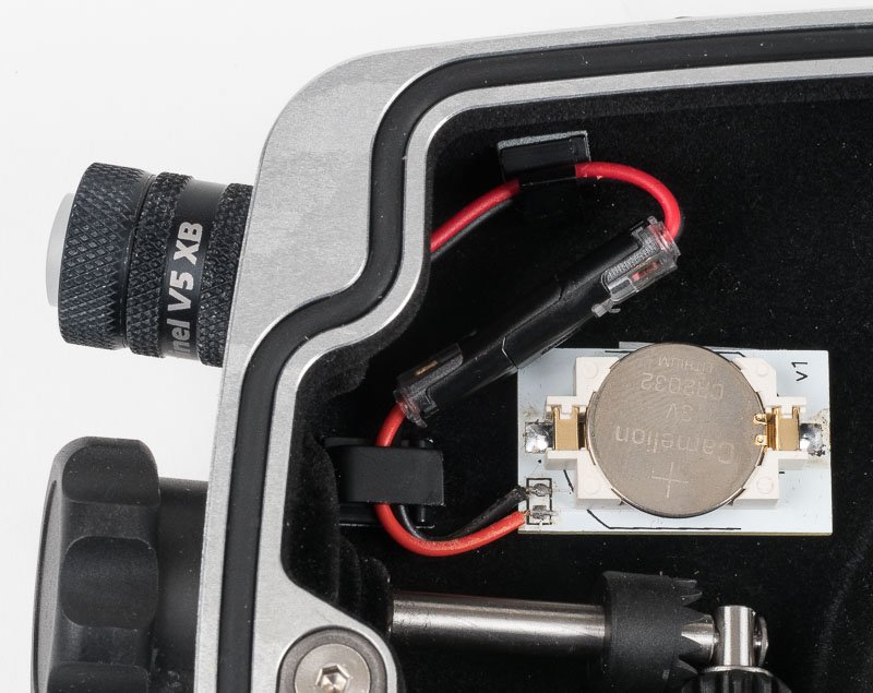

    There was a small difference between the V5 XB that I received and the pictures that I shared initially: there are no "splicer" connectors to connect the wires to the battery PCB. Instead there are small connectors on the PCB, where the wires can be inserted and fixed without soldering. The small jumpers used on these connectors to unplug the wires, which was very convenient to uninstall and reinstall the Leak Sentinel to the other connector. The only drawback of this option is that you need to be careful as the connectors are small and delicate. You need to be careful when connecting or removing the wires.
    This new version of the battery PCB also has an On/Off switch which enables to disconnect fully the battery from the Leak Sentinel, and prevent it from being drained during long storage.
