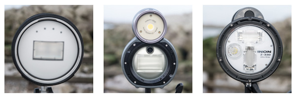

    I have just posted the Wetpixel review of the Inon Z330, Retra Flash and Symbiosis SS2 strobes on the front page:
    http://wetpixel.com/articles/strobe-tests-inon-z330-retra-flash-and-symbiosis-ss2
    If you are just coming to this, please check out the extensive threads on the Z330 and Retra Flashes too:
    Z330: http://wetpixel.com/forums/index.php?showtopic=61091
    Retra Flash: http://wetpixel.com/forums/index.php?showtopic=59574
    Perhaps we can amalgamate the threads and add personal experiences to this thread?
    Adam
