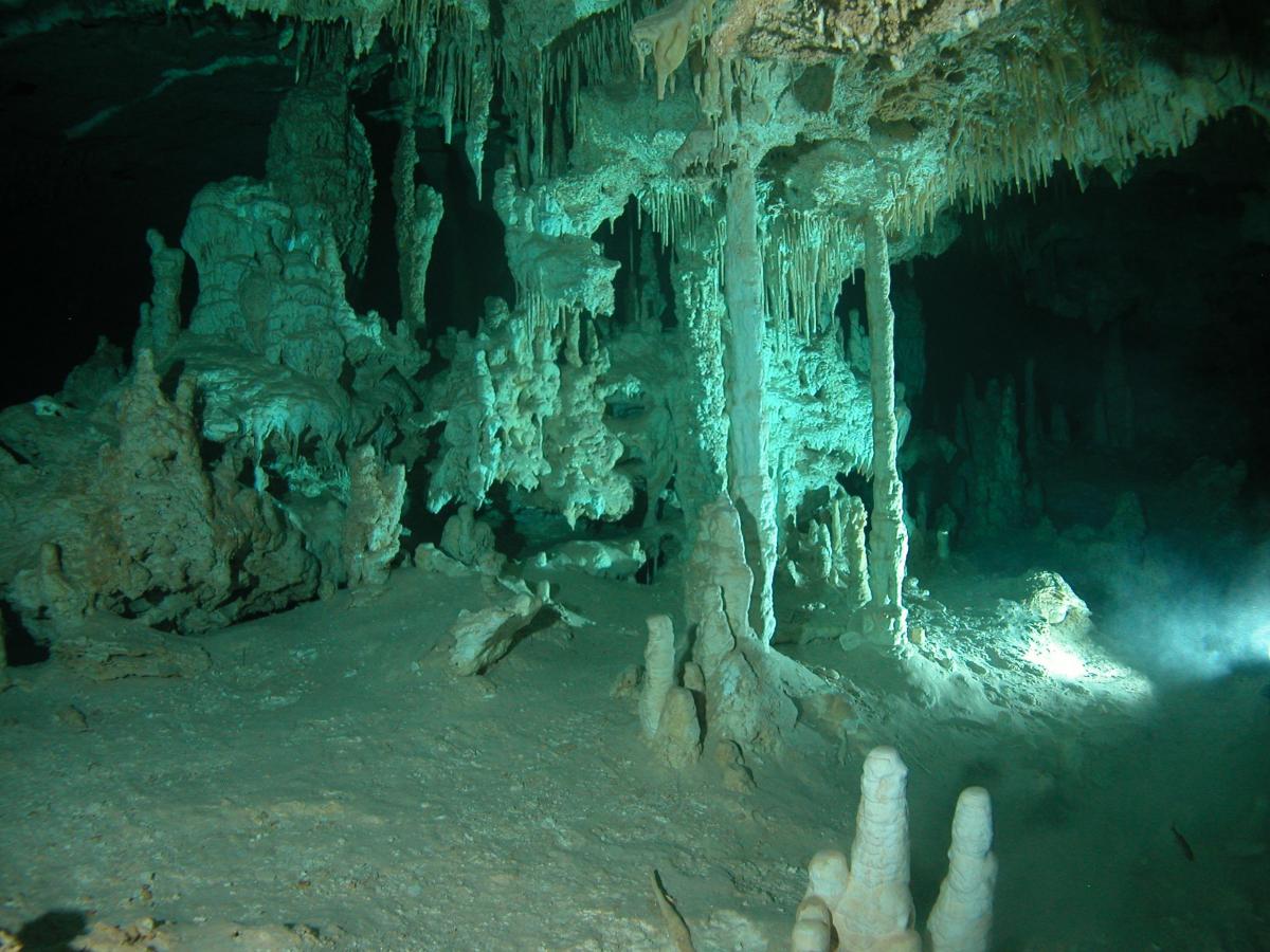

  19. I just got my Ds161 in the mail and thought I would do a comparison of output powers . It wasn't exactly controlled but close enough to get the idea. I set up a DS125 and DS161 in the same spot and then at a marked distance about 20 inches away took a reading with my Sekonic 758 light meter. The DS161 has ten power levels and the 125 only has 4. The lowest power setting on the the DS125 was level 3 on the DS161 meaning you could go almost 2 stops lower on the DS161. Each level on the DS161 was about .5 EV at the lower end. As far as full power the DS 125 had the same max power as the DS161 did, in fact the DS125 would be about a tenth of a stop brighter. If you need fine tune lighting, go with the DS160 or DS161. Both these strobes work off TTL, which means you can get the same results with the DS125 as you can with the DS161 using TTL. The biggest difference is price since the DS125's are substantially cheaper. So if you don't need small incremental changing in the amount of light you want the DS125 is what you want. You can also use an EV controller which has 10 power levels available. If you can trigger it optically as a slave with the setup you have the DS125 will do everything the DS161 will for a smaller price.
    Lets compare the price between the two setups for remote slaves.
    DS125 - $250 on ebay + EV Controller $180 = Total $430
    DS161 / DS160 + EV Controller $180 = $880 / 630
    $700 / $450
    All setups should give the same results but the DS125's are substantially less.
    You pretty much have to have remote strobes for the caves. So for me it's an easy decision.
