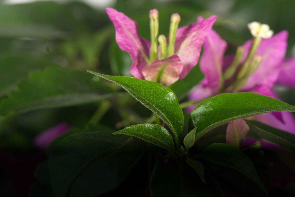

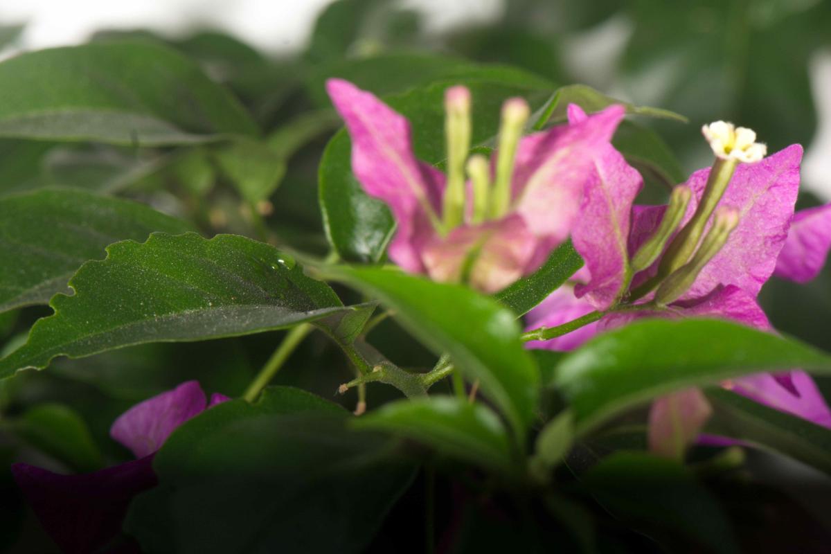

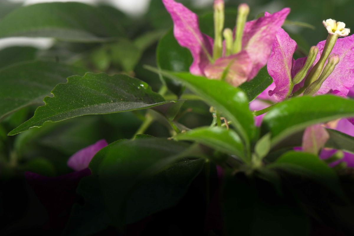

    Shooting Nikon D7100 in Nauticam housing with dual S&S YS-D1 strobes and fiber optic cables. Random pictures over the last year have dark band across bottom when shooting in TTL mode (see below/attached).
    All 3 pictures shot with Nikon 105mm lens, f 1/13, ISO 160, TTL, Spot metering
    1st picture is 1/320 shutter speed, 2nd one is 1/250, and last one is 1/200
    Purchased second D7100 camera and D7200 camera and problems persisted - so not the camera.
    Synch speeds set to 320 AP, 250 AP, 250, and problems are still there.
    Today we put camera on tripod and replicated problems on land (same setup used as when diving).
    Any thoughts ????

  6. Dark strip on images is shutter 2-nd curtain. It became visible in shutter window at the moment of flash, because of inconsistent flash sync speed setting in your camera menu.
    Nikon D7100 has mechanical shutter, which makes fully open window at max fast speed 1/250. If you set faster speed (1/320 or faster, or FP speeds), then camera mechanism does not make fully open window at all, but just an open strip which moves along the window (2-nd curtain goes after 1-st curtain faster), the more fast speeds cause more narrow open strip.
    Regarding "FP" flash sync speeds in camera menu *
    Nikon FP is fast shutter speed shooting method, when camera initiates Nikon land strobe to burst 40khz multi-pulses.
    But underwater strobe cannot burst 40 khz FP light, underwater strobe burns only continuously in a single pulse. That is why underwater strobe must burn only at the moment when camera shutter window is fully open, to light the full shot. Such shutter speed, when window is fully open, was named as "X-sync speed" in photography technics.
    The maximum x-sync speed which you can set in D7100 menu is 1/250: Bracketing/Flash--->Flash sync speed--->1/250. But, without "FP" !! Only this case underwater strobe will light the full shot.
