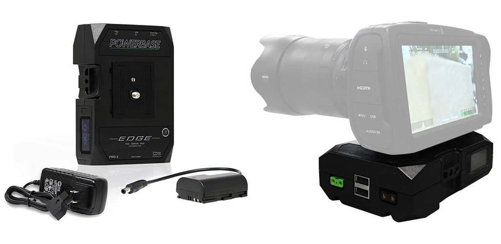

    Another point I keep hearing about this new camera is that battery chosen to power it is ridiculously in adequate. A power source that can only keep the camera running for 35 to 40 minutes is far from enough for underwater usage. But, there is a very viable solution. One of those being the Core SWX Powerbase EDGE 14.8V, 49Wh, Lithium-Ion battery that can easily works with the Blackmagic Design Pocket Cinema Camera.
    Although this external battery is nearly as large as the Pocket Cinema Camera body, it can provide more than triple the runtime of the camera, even when shooting RAW. The mounting system is apparently simple to rig up where you have a quick release plate on the battery to which the camera is mounted directly on top, and a V-Mount system on the underside so that it could be attached to an underwater housing plate like the ones used in Nauticam’s housings. The key there is that the designer of the housing also incorporates the added battery system.
    Yes, it will make the housing bigger, but one must not forget the higher the mass of the housing, generally equates to greater the stability underwater when shooting video. And the price for the Core SWX Powerbase EDGE battery should not break you either at $264.00 USD at B&H - https://www.bhphotovideo.com/c/product/1416942-REG/core_swx_pbe_bmpc4_powerbase_edge_small_form.html

  12. 200 min of run time from 4x 18650 should be sufficient, right?
  13. 200 min of run time from 4x 18650 should be sufficient, right?
    Even more would be better.
  14. 200 min of run time from 4x 18650 should be sufficient, right?
