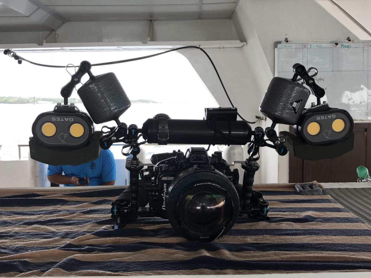

  1. This is probably not the most elegant setup, but the rig is neutral in the water and massive enough to give pretty stable footage.
  2. This is probably not the most elegant setup, but the rig is neutral in the water and massive enough to give pretty stable footage.
    That’s the key, being neutral - does matter if it looks weird. That’s the only issue with these ‘slim’ housings compared to gates and the like. They are neutral to begin with - we have to slap on all sorts of float arms.

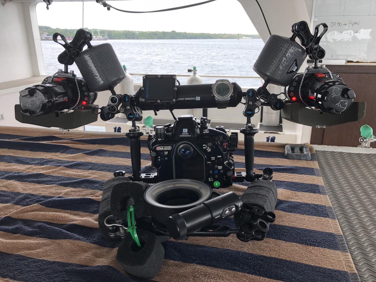

    Do you find the float arms give you enough separation to avoid backscatter?
    Love the computer mount. That’s nice and easy to see.
    How have you got the rear configured? Looks like it comes out flat (towards you) ?
  3. That’s the key, being neutral - does matter if it looks weird. That’s the only issue with these ‘slim’ housings compared to gates and the like. They are neutral to begin with - we have to slap on all sorts of float arms.
    Yes, there's enough separation to avoid backscatter with subjects within a meter of the lens. The lights aren't really strong enough to make a difference with objects further away. If the object is closer than about 30 cm, I need to turn the lights inwards to light it properly. But it's worth noting that the GATES GT14s have a 90 degree angle, whereas the V6Ks have a wider angle around 120 degrees so they need to be further out.

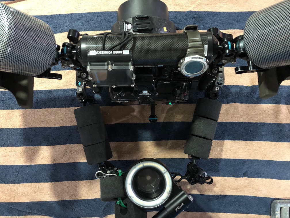

    I've got three arms with stix floats rigged up at the back (connected to the tripod-mount ball arms) to provide a place to store my wet diopeter and Weefine ring light combination. The 9 stix jumbo floats basically render that setup neutral, so the whole rig is neutral with the ring light or without it (if I'm doing a wide-angle only dive). I also find that having the rig extend at the back like this helps to add a bit of mass and roll stability.
    (As a side note, I have 4 V6Ks in my possession currently. Two of them together are not quite as powerful as a single GT14 (maybe about 75% as powerful). I don't know if this is because the wider beam angle distributes the illumination over a wider area or because the 12000 lumen rating is overstated or a combination of the two, but I guess you still get what you pay for at the end of the day. I haven't compared the V6Ks to the Keldan lights directly though, so maybe that's a more even battle.
